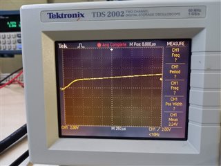

Our customer is using the LM5122 and they are facing some issue. Kindly see the info below.
"I have some questions about the working of the LM5122 IC
We created a DC-DC converter of 4.5V/50A to 24V
However it seems that too much current is required which causes the power supply to shut off
So the problem is that when I turn on the power supply the system will immediately turn off
* The schematic doesn't show any Css however this one was later added 100nF
Also only two of the three mosfets that are drawn are actually connected
I also have a image of the simulation where this design is based on but not the actual simulation files
Thank you for your help.
Cedrick

    "What kind of turn-off did they see? : Power source would shut off automatically when the working voltage of the LM5122 was reached (4.5V). The coils on the PCB would then slowly discharge.
    Was the controller not switching? The Lo was providing a PWM signal shown in the 20210413_122417.jpg. However, the Ho was not providing a PWM signal which was expected shown in 20210408_103631.jpg.
    SS was connected with an 82uF capacitor to ground but does have a charge. When the Css is not connected this is the Lo (20210408_103827.jpg) signal.
    VCC drops when the source shuts off.
    The waveforms are Lo (20210413_122417.jpg) and Ho (20210408_103631.jpg) for both ICs the same waveform was generated.
    Lo:
    Ho:
    Cedrick
  • Hi Cedrick,
    Thank you for the information. When you say "power source", are you talking about the VIN in the schematic?
    If the LO is still switching, the output voltage could still be charged through the body diode of the high side FET. What is the output voltage in that case?
    Yinsong
  • Hi Yinsong,
    Good day.
    "When you say "power source", are you talking about the VIN in the schematic?
    --Sorry for being unclear, correct that is what I meant.
    If the LO is still switching, the output voltage could still be charged through the body diode of the high side FET. What is the output voltage in that case?"
    --The output voltage is slightly below the input voltage (Vin). When Vin is about 3V it measures at about 2.3V.
    Cedrick
