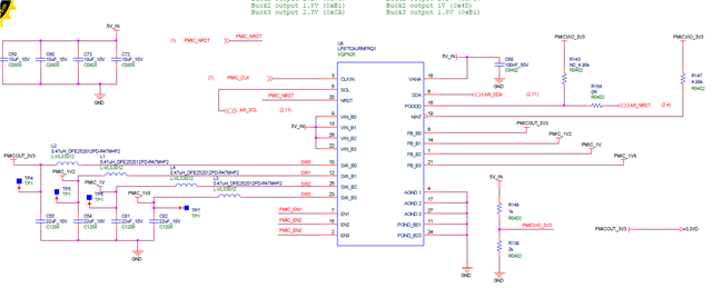

Such as the SCH below
If I want to directly input 3.3V to LP87524J, and only enable 1V, 1.2V, 1.8V output, how can I change it without affecting the output of PGood? THX
If you want to use 3.3V input voltage, then you can use LP87524P part number instead. Please see the technical reference manual for more information: https://www.ti.com/lit/ug/snvu663/snvu663.pdf
Thanks.
-Tomi
Hi Team,
They can only use the LP87524J used by the customer’s factory that has been mass-produced. Please help to confirm again. Thanks
They can disable the 3.3V buck with I2C write before setting EN pin high. This will prevent the PGOOD triggering.

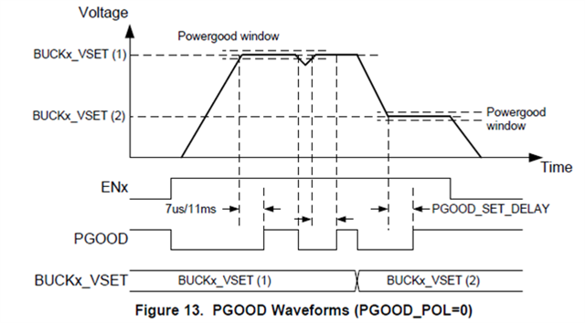

Hi Team,
Is there a mistake in understanding the following figure:
1. PGOOD will be active when EN is not enabled
2. PGOOD will be pulled down if the output voltage is not at the set level after EN enable
3. If the output voltage is modified after EN enable, PGOOD will be pulled low first, and it will become active only after PGOOD_set_delay
Hi Kygo,
Yes you understood correctly. PGOOD is only monitored when bucks are enabled, so when EN is low PGOOD is high. Also during output voltage change the PGOOD goes low momentarily.
Thanks.
Tomi Koskela
