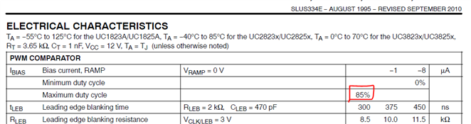

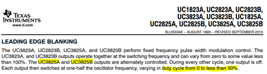

For the max duty cycle value, the expression 50% in the "ordering information" part and the expression 85% in the "electrical characteristics" part are used in the datasheet.
It is important that the max duty cycle is 50% for our practice. For this reason, can we confirm that the max duty cycle value is 50% for the two PN below?
UC2825ADW max duty: 50% ???
UC2825AQDWRQ1 max duty: 50% ???
