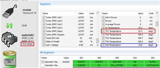

hi,
Why the Cell temperature is different with TS1?
the setting is as below.
do I missing something?

Hi Frank,
Please check if SMB_CELL_TEMP bit in Settings: Configuration: SBS Configuration is set, if so, set it to 0.
