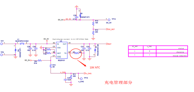

The pin description of /CHG tells it goes low (FET on) when charging and open drain (FET off) when no charging, some tests don't match the description:
The NTC is connected on TS pin, and /CHG pins is pulled up to 5V.
1. When BQ25101 is put into the ambient under 0℃ or over 60℃ for more than 30 minutes,  then plug the power adapter, /CHG pin goes high whether the load is 3.6V electronical load or battery, and the current from power adapter is almost zero.
2. When BQ25101 is put into the ambient and plug the power adaptor, BQ25101 starts charging, then raise the temperature over 60℃ or lower the temperature below 0℃, /CHG pin keeps low with 3.6V load, but the current from power adapter is zero.
Could you please help confirm why sometimes /CHG keeps low when there is no current?

  • Hi Hao,
    Can you attach the schematic for review.
    Nick
  • Hi Nick,
    Here is the schematic, R5 is the NTC, the part number is NTCG063JF103FTB.
    Best Regards!
    Hao
  • Hello Hao,
    When you remove the 20k pulldown on /CHG do you see the same behavior? The pulldown is not needed here.
    Nick

  • /CHG would be high when not charging and when charging reaches termination.

  • Hello Hao,
    Sorry for the delayed response.
    I was able to see identical behavior in case 2 & 3 with bq25101, using 5V supply on IN and battery simulator at 3.6V on OUT. I altered the TS voltage with potentiometer.
    2. When TS voltage is higher than VTS-0°C to simulate the cold environment, there is no charging current, however /CHG is low as the D2 is always on rather than off.
    3.  When TS voltage(such as 0.17V) is a little below VTS-60°C to simulate the hot environment, there is no charging current, however /CHG is low as the D2 is still on. /CHG turns high as The D2 is off until the TS voltage reaches 0.04V or lower.
    As stated in the d/s 8.3.2, the /CHG pin is low during the first charge. If the NTC resistance is out of range before adapter is connected charge never begins and so /CHG does not go low. Pulling the TS pin low causes /CHG to reset. In your case 2 & 3, it is possible to turn off the LED also by cycling input power.
