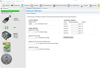

I found a problem with the interface Battery Managment Studio.
In applications with current scaling, you need to calibrate with a higher current which should be entered in the "Applied Cutrrent" field.
If the calibration is performed when discharging, you must enter a minus sign, and this field accepts only five characters, which limits the calibration current to -9999mA.
Probably the second error is when I manually enter CC Gain, because it is impossible to manually enter a value lower than 1mOhm, eg. (0.5 mOhm)  and the automatic calibration enters the correct value even if it is below 1.
