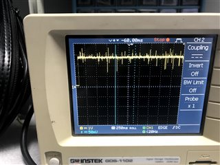

  • I am working with the scope now, this new regulator that I am using now is also not working properly but in a different way. I will share pictures in a minute.
    Vout stays low after discharge. Vout stays at peak value 5v for only a quick second then starts decaying.
    Now this reg. is outputting a 2.6v no square wave.

  • My schematic is the one posted in the question, I start by putting 4v on the circuit then step it up. I haven't gone over 15 v yet. My load is well below 1 A.  I will check the values on each pin.
  • Checking the absolute ratings from the data sheet:
    Fb = .625v
    sw = 2.6 v
    cb to sw = 5.24v
