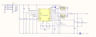

Can we use LM5116 for 12V to -55V/1.4A application. Could you help review the schematic? thanks!
Vin=12V

Hi Jimmy,
This topic is already discussed on this thread: https://e2e.ti.com/support/power-management/f/power-management-forum/995448/design-a-ibb-that-meeting--55v-1-4a-output-when-input-12v
My recommendation is to add more ceramic input capacitance from VIN to -VOUT across the FETs as this provides the switched current to the power stage. Also, consider increasing the soft-start cap given the high Cout value. Finally, check compensation based on the output cap effective ESR.

Hi Timothy,
I use TINA to simulate LM5116, but can not work.
Could you help me check the schematic correctness? thanks!
HI Jimmy,
This may be related to the GND connection in the model for IBB. Another option here is PSPICE for TI.
Tim
Hi Timothy,
So TINA can not do this simulation(GND connection)? Could you please help confirm the schematic?
The design condition 12V to -55V can normally work?
Try this link: https://www.ti.com/lit/an/snva856a/snva856a.pdf ...or search for snva856 on ti.com
