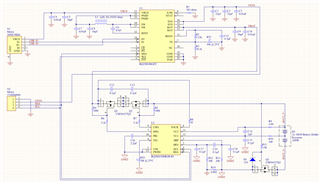

I'm having some issues with the BQ28Z610-R1, and to help solve it I got a few questions. For reference, this is my circuit, using the BQ25883 as charger and the BQ28Z610-R1 as gauge:

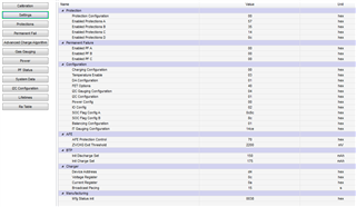

PS: This is my BQ28Z610-R1 settings:

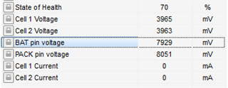

  • Continuing: I thought this issue could be a result of a bad solder at the BAT (VC2) pin, but the BAT pin voltage being reported when the system is working with only the batteries (no USB cable) is this:
    Therefore, I assume this part is ok.
    Also, the PACK pin voltage is 8.051V, which is greater than the BAT voltage. I assume its just a result of the 17.2V at the DSG pin.

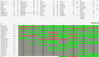

    For more details, this is the entire Registers screen when the system has only the batteries (no USB cable) and nothing using the batteries (nothing discharging):
