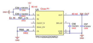

Hi Team,
There is a good new that DIN TPS1H200A-Q1
Please help check this SCH, THX
  • Hi Kygo,
    Two comments we have:
    1. If you can replace the R47 with 10k resistor it can better control the current - although 4.7k is fine.
    2. The Fault and Diag pins are not used. In this case, you wouldn't know if device is going to overcurrent protection. Is there a particular reason these pins are not used?
    Yichi
