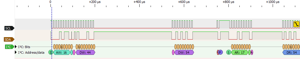

  • Vos, thanks for understanding. I've gotten some captures for us to look at.
    Above being read of OperationStatus, returning as expected.
    Above being failure of MfrBlockRead for the same command, 44 54 00. The STM provided SMBus HAL fails the same way. I'm digging deeper but this looks like device-directed behavior. Despite the NAK the device echos back 54 00. The number changes based on the command I attempt.
  • I've found the issue. One must write exactly "44 02 54 00 \" and then read "44 ... \"
    The documentation could be clarified on this matter, I see now how I was reading it wrong but there are devices that behave differently. At the very least it would be best to return nothing or NAK the read instead of return zeros. This would have tipped me off to the issue earlier.
