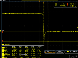

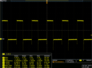

I observed some ringing at the SW node, which causes it to have negative spikes at every switching cycle. I measured close to -2V for about 5ns. In the datasheet the minimum voltage specified is -0.3V for SW pin. Is this spike acceptable?

Vin 3.3V, Vout 1.2V, loaded at 1.5A
I don't have the Vin Vout and SW in the same screenshot though. I'll paste SW for now, if you really need the Vin and Vout I'll capture and them later, is that okay?

The spikes seem ok to me.
The high frequency ringing (usually < 10ns) on the SW node is intrinsic of the converter behavior.
The absolute maximum rating of -0.3V refers to 'DC' conditions (usually > 10ns).
I leave you as reference the waveforms acquired on the device EVM for Vin 3.3V, Vout 1.2V, loaded at 1.5A.
