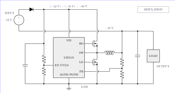

I want to create DC-DC Converter using LM5145 to convert +12 V to -48 V.
I still working at simulation level and the result is the output voltage drop before
reach -48 V. How to fix this?
Maximum output current needed is 4 A.
this is simplified diagram for implementation:

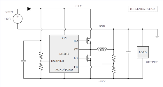

this is simplified diagram for simulation, i just choose different node
for ground:
