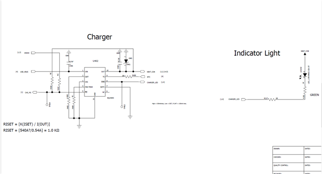

The customer design with BQ24093, and find some queries.

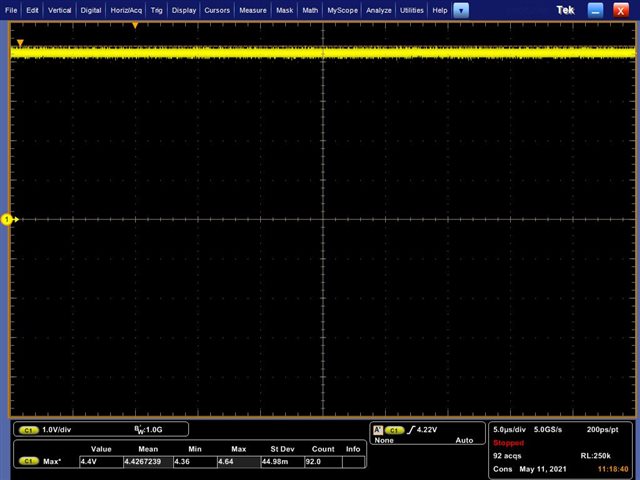

1, When adapter connect the out has 1.8V output and the charging indicator will stay on
2,The charging current is set to 140mA, but the current only 23mA, and still charge, the charging indicator is on.
3, After setting the charging current to 540mA, the charging indicator can turn off, Is the cause of problem 2 because the charging current setting is too small?
Waiting for your reply.
