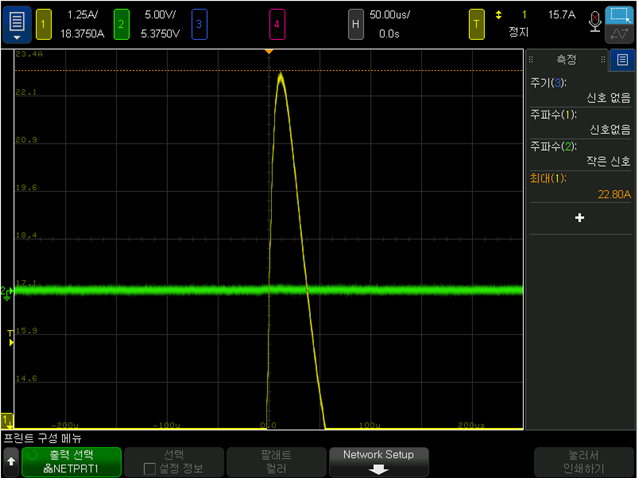

When the power of the product is supplied to the power supply, inrush current occurs, and the product does not operate afterwards.
It is reported that a higher inrush current occurs during the test after mounting on the actual vehicle, and it is reported that the product is dead and does not operate again.
[Iin : Inrush Current, yellow]
[Vin : Blue, Vout : Green]
Are there any defects caused by inrush current?
There seems to be no comment on Inrush in the datasheet, but if there is any data related to Inrush Current, please forward it.

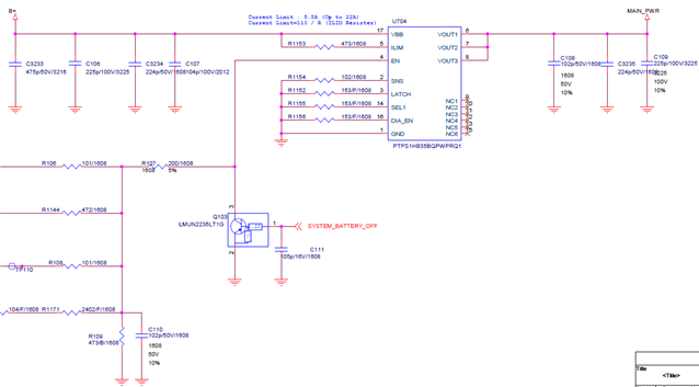

In addition, we will share the circuit diagram, so please review it.

    Thanks for contacting us. It looks like the current limit resistor used is out of range - the range for Rilim is between 5k to 25k. While the Rilim is out of range, the default current limit will be 22A for B version, and thus what you see in the first screenshot. I will suggest you start with 25k, and only use one output port first and make sure the device is functional, and then you can adjust the Rilim value and number of output ports that fit your application.
    What's the Vbb voltage in this case? I wonder if the large power dissipation caused by 22A of current damaged the device (inrush happens fast before thermal protection kicks in). Have you tried to power cycle the device and it still won't work?

    The current limit functionality is intended to limit the inrush current as well. As I pointed out in the previous post, the Rilim resistor used now is out of range, which means the current limit now is 22A. First thing to try is to change the Rilim to 20-25kohm and test again.

    3. R1154 (RILIM) is now in NC (No Connect) State.

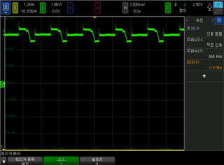

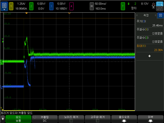

    4. Immediately situation after Power ON [Vin_ : Blue,ut : Green] (Vout Fault situation)
    5. Vout in case of power Power failure
    6. Can TPS1HB35 return to normal operation after power stabilization ??

    Leave Ilim floating (without connecting a resistor) will set the current limit to highest value, and enter fault state automatically. I would suggest you use resistor from 5-25 kohm for Rilim.
    As you connect Latch pin to ground with resistor, it will trigger the device to be in latched mode once fault occurs. If you want to have auto-retry mode, leave the Latch pin floating.

    When I look at the waveform more closely, actually it's doing the auto-retry as the Vout is changing every 2ms, which matches the auto-retry period. One thing I'm thinking is the combination of current and voltage hit the device energy limit every time when it's trying to restart.
    Could you try higher Rilim resistor such as 20k, and reduce the number of output channel used to reduce the current? I'm not sure if you are capable of reading the FAULT pin - that will give us extra information.

    Could you capture the input current along with input and output voltage in the same screen capture?
