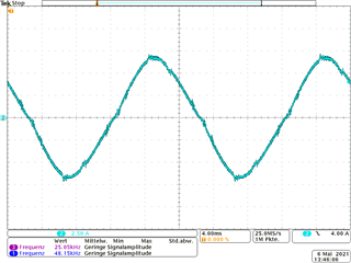

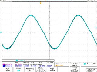

Hi all,
We are using the UCC2818 with the synchronisation circuit refered in application note "SLUA245 - July 2000".
Like described in application note "SLUA296A - October 2003 -- Revised April 2010" we can observe the negative effects on the current (left image).
Without synchronisation (and a smaller CT to maintain 145kHz switching frequency) those effects are non present anymore (right image).
However in free running mode the frequency tolerance from the datasheet is very high with +/-20%.
Which parameters have the most effect on this variation?

    thank you for the fast response.
    At the pins from the IC there are no differences measurable.
    The picture shows the synchronised waveform and the unsyncronised one (two different modules)
    The free running frequency is set to 116kHz and it gets synchronised to 145kHz. With the synchronisation the gate is driven at a frequency of 145kHz.
    For the module with free run we have also tried a smaller CT to have free running 145kHz but no distortion on the mains current were visible.

    the dutycycle got limited from 92% unsynchronised to 85% synchronised. Therefore the PFC was not capable of boosting voltages <60V and the current controller got saturated.
    However reducing CT from 470pF down to 100pF only brought minor improvements. To me it seems the discharge time is limited by the controller itself. Additionally a CT of 100pF would result in a bootstrap capacitor >24pF. To have some tolerance 30pF were tested. It works fine for 85VAC-230VAC. Above 230VAC (up to 265VAC) the mains current gets distorted again. (It looks fine while free running at 145kHz).
    Using a bigger bootstrap capacitor leads again to a longer discharge time and therefore more crossover distortion.

    the spike after the flat spot is caused by the current controller which gets saturated at crossover.
    At higher AC input voltages the distortion around crossover gets bigger until at 265VAC the signal is completly distorted. Unsynchronised at 145kHz no problems can be observed. These distortions only appear in combination when synchronising the controller.

    Without the synchronisation circuit from "SLUA245 - July 2000" there are no big crossover distortions. With the synchronisation the behaviour of the chip changes dramatically and does not meet the requirements (see my post from may 7th 10:06AM).

    the flat spots at crossover are not my problem but the oscillation the whole current is. This is already with a reduced CT. It does only occur when synchronising. While free running at 120kHz and 145kHz there are no oscillations.
    The chip/synchronisation circuit is fixed and cannot be changed unfortunatelly.
    The following is the waveform you reported and issue on.  Has this changed?  This is caused by the limited duty cycle of the sync circuit you verified.
  • It has changed 4 days ago in my post from May 7th 10:06AM
    Could you tell me what the THD and PF is for the waveform in question?
    I did review your last waveform below and can see high frequency ringing on it.  I would not think this would be due to the sync circuit.
    Is this the waveform in question?
  • Even if the THD and powefactor meet the requirements there is something wrong with this waveform that needs to be solved.
    Unsynced at 145kHz: Proper sine wave with little to no distortion at crossover
     Unsynced at 120kHz synced up to 145kHz: The waveform from above with a lot of ringing.
