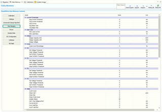

    4. I see you are suggesting to modify some of the parameters in settings. Can you advice with respect to below table available in BQStudio? This will help to make sure we remain on same page as suggested.
      1. There are lots of parameters that need to be updated. The ones in regards to VCT are the charging voltages inside the different temperature ranges on the "Advanced Charge Tab"
