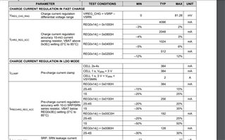

Now, when I start charging the battery from <3 V, the charger always outputs a slightly lesser current than what I send. For instance, if I send 128 mA to the charger through the command, it outputs around 113mA. For 320mA, it outputs around 300mA. As soon as the battery crosses around 3V, the current goes up to the correct value. I'm not quite sure how to fix this, and was wondering what settings in the charger I can change.

    1. How are you measuring the charging current level? Are you reading it on a DMM? 128 mA/113 mA and 320 mA/300 mA seems very close and it could just be a measurement error. As for charging current not being accurate at < 3 V, the BQ25700A has a current clamp at voltage < 3 V as the charger is in the pre-charge stage (if REG0x12[2] = 1 which is the default).
     *section 8.6.3.1 of datasheet
    Other than that, the current regulation will be less accurate in the pre-charge state than the fast charge state which the IC will enter at 3 V. You can view this at page 10 of the datasheet. 128 mA/113 mA and 320 mA/300 mA seems acceptable to me in LDO mode.

    1. I am reading the charging current and voltage both through a DMM and through a BQ40z50 gauge. I'm pretty sure this isn't a measurement error, since there is a pretty clear change in the current (both as measured by the gauge and the DMM) as soon as the battery crosses 3V. If I change the Minimium System Voltage to 2560 mV at REG0x3E, should that fix the issue? Basically, I'd like to ensure that I can specify the current manually over the entire battery voltage 2500 to 4200 mV.

    1. I changed my response a bit (just before your replied). When the part is in pre-charge mode and the battery voltage is < 3 V, the charge regulation will be less accurate. The variation could be as much as 50% as listed on the EC table on page 10. This is by design.

    1. I was able to resolve the first issue with regards to the clamped current. Reducing the VSYSMIN did the trick.

    1. Glad it solved your issue. I also did some testing in the lab. It seems that even in the 1S setting, lowering the minimum system voltage put the charger out of pre-charge state and therefore leading to more accurate current regulation.
