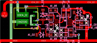

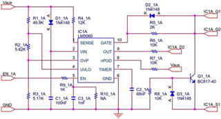

Dear team
There is a good news that we design in LM5060 in customer's new project.
Could you help to review the schematic and layout?
many thanks
Denny

Dear Rakesh
Customer need to control the switching element (2 in 1 N-ch Mosfet) to switch on/off (short or open) according to the signal, current direction is bidirectional.
many thanks
Denny
Thanks Denny.
Both schematic and layout looks good to me. Please proceed.
Rakesh
