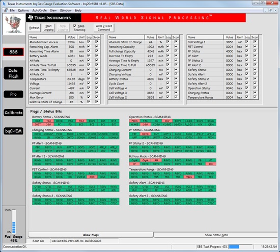

HI,
I am trying to write to the data flash on a new battery design using the BQ20z65-R1 v1.05, but the aval software does not seem to be able to update the data flash.  When I write to any of the registers they just turn red and revert to their original value.  The SMBus communication works with all the SBS registers being read correctly.
I tried using bqChem and when that tries to write to the BQ20z65-R1 in order to update the chemistry, I get the following error: Writing Chemical Data, bqChemOCX - Fail read Verify, Abourt SubClass83 programming.
I can write to ManufacturerAccess, e.g. turn on the LEDs.
Flags/Status register summary:
BatteryStatus = TCA, TDA, INIT, DSG
OperationStatus = PRES, DSG, R_DIS
Do you know why I cannot write to the data flash?
Many thanks
Steve

    Thanks for your reply.  Answers to your comments are below.
    Chase said:
    1)  First, make sure the gauge is not in shutdown or sleep and SMBus communication is working.   SMBUS Communication is working.
    2) If the device is sealed, reading and writing to flash is forbidden.  Device must be unsealed first. If the SS or FAS bits in Operation Status, then the device is sealed.  SS and FAS are clear, it is a new device on a new PCB.
    3) Make sure there are no Permanent Failures.  A PF prevents data flash writes.  Data flash reads are still allowed.  The RSVD bit in PF status is set, all other bits are clear and PF in safety alert is clear
    4) Check the battery voltage.  If it is lower than the Flash Update OK Voltage (located in Power class of data flash), then data flash writes are locked. Apply a charger voltage above the Flash Update OK Voltage to allow changing of this parameter to a lower voltage.  The battery voltage is reported as 11419mV, the Flash Update OK Voltage is 7500mV.  It makes no difference if I apply a 16.8V charge voltage (it is a 4S core pack I have connected).
    Below is a screen shot from the EVM software.
    Below is a screen shot showing what happens when I try to write to the DF:
    Many thanks for your help.
    Steve
  • The RSVD bit that is set is what is causing your problems. Reset the gauge (send 0x0041 to command 0x00) and this will clear the RSVD but, thus allowing you to write to flash.

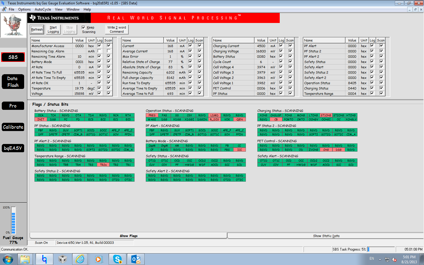

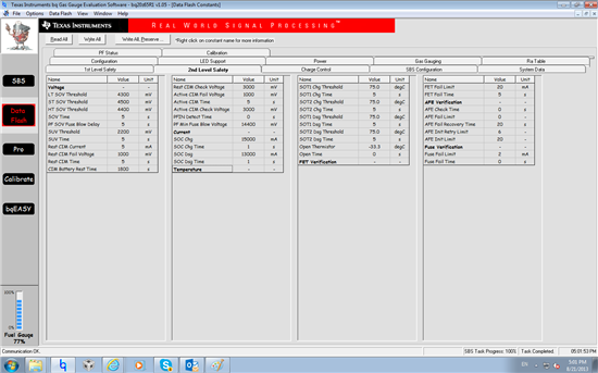

  • I don't have PF bit set. But still I can't change the data flash. I tried to write to SUV time to be 0 to disable SUV. But I can't write the flash. It does not change value. If happed before that I need write many times to change one value to make it happen.
  • Check to make sure your device isn't sealed.Can you send a screen shot of your sbs screen.
    thanks
    Onyx
    It is not sealed. I can read out the data flash. Please see the screen shots.
    Thank you very much.
  • Is it just that parameter which you can't change. Try changing the paramaters on the gg file and then loading it on the gas gauge.
    thanks
    Onyx
  • Onyx,
         Thanks. I modified the parameter in the .gg file and import it and use " write all" to update data flash. But some items becomes red colored.
