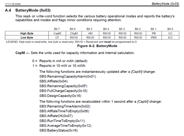

Hi team,
Can you have a look at the following customer question please?
I can display the capacity values either in mAh or mWh by the CapM bit. I have set the bit and the values for e.g. the Remainig Capacity are now displayed in mWh. Originally my battery displayed 4312mAh, after setting the CapM bit it now displays 59780mWh. If I calculate the voltage from both values I get 13,863V. Where does the BQ get this voltage when it converts the values ? Which voltage is used for the individual capacity values e.g. Full charge Capacitiy etc.? ?
Thank you,
Franz
