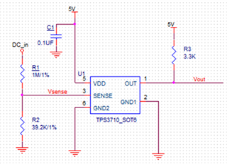

TPS3710: Schematic reivew
Part Number: TPS3710
Dear team
There is a good news that we design in TPS3710 in customer's new project.
Could you help to review the schematict?
voltage of DC_in = 12V~5V
if  voltage of DC_in > 10.6V, Vo=5V
if  voltage of DC_in < 10.45V, Vo= 0V
1. VMON=10.45V
2. VMON=10.6V
many thanks
Denny
