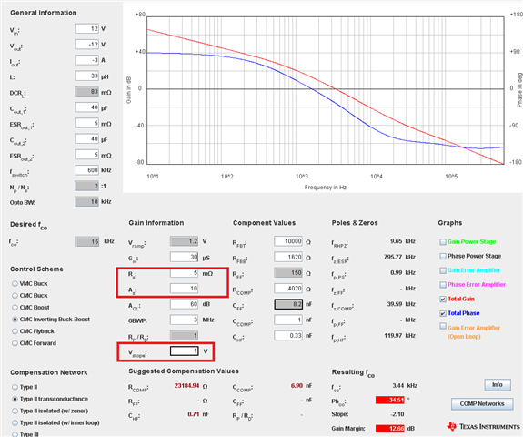

I want to design " CMC Inverting Buck-Boost"  (Compensation Network is Type2 Transconductance)
There are several questions:
1. Does Vref is fixed in Loop caculator?
2. How do we decide the current gain & Vslope(I mean : Rs ? As?) If I want to design the current gain =0.2 , Rs=200m As=1 --> Is it right?)
Thanks!
    1) Yes, the reference voltage for the TPS54620 is internally fixed at 800mV
    2) The TPS54620 uses internal Rdson current sense.  The Current sense gain is set at 16A/V internally to the device.  The effective Rsense for the current loop is 1/16 = 62.5mOhms.
    3) The TPS54620 has internal slope compensation.  I don't see the details of the ramp in the datasheet.  If you need them, let me know and we will get them for you.
  • Hi Peter
    Thanks a lot!
    So how do I set the Rs As Vslope in TI's Power Stage DEsigner Tool
    I provided you with Rs, which is 62.5mOhms
    As is the current sense gain, which is already included in the Rs in this case, so you'll want to set it to 1.
    Vslope I will still need to look up, but starting with 0 would provide a conservative guidance for loop design.
    The Slope Compensation in the TPS54620 is 9A or per switching cycle or 0.5625V per switching cycle.
    I Believe the Power Stage Designer tool wants the slope compensation in peak voltages not per switching cycle volts, so you need to apply a --VOUT / (VIN - VOUT) duty cycle factor to the slope compensation.
    Since the TPS54620 will see the full VIN - VOUT voltage (VIN + |Vout| ) since Vout is negative) it is important to make sure VIN - VOUT does not exceed the TPS54620's input voltage range.
