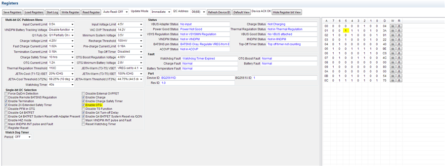

  • Hello Wyatt,
    Good day.
    My customer response is:
    Yes now I'm making some test with bq25611DEVM, I'll attach you a picture.
    charge.zip
    Register 1 set to 0x30, if I attach the adapter I see 5V on VMID (instead of 4.6V of boost), but the charge does not start... no changes on registers.
    If I just unselect "Enable OTG" from BQStudio charge start correctly. I'm starting to think we could have a different version of the IC? I have BQ25611D REV ID 1.0 read from BQSTUDIO? Maybe there's a newer version? I'm wondering about a bug in this version?
    Renan
  • Hello Renan,
    There is most likely a hardware issue, I tested with the same register settings on the EVM on my bench, the charger always switches between modes. I have attached a picture of my testing. You can see the switches between modes:
    Regions:
    1. OTG disabled, adaptor unplugged
    2. OTG enabled, 4.75V regulation
    3. Plug in adaptor at 5V (set the OTG_CONFIG bit again to 1 in this region)
    4. Unplug adaptor - short pause between modes
    Sincerely,
    Wyatt Keller

  • Hello Wyatt,
    Here you find the configuration my cusotmer test today; actually it is the default configuration, changing only regulation voltage to 4.6V and setting Enable OTG bit.
    I read correctly 4.6 on VBUS, I plug the adapter with 5V, I see 5V but charge does not start.
    If I disable the ENABLE OTG bit, charge start.
    (forgot to disable the Watchdog Timer)
    Renan

  • Hello Renan,
    Ricardo is correct, the other devices (bq25618 and bq15619) are better suited for your application because of the PMID pin. I would follow this recommendation because the detection of an adapter on VBUS may not always work because VAC will have difficulty detecting the voltages that are so close.
