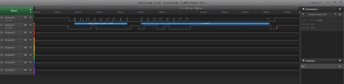

We have a custom board and there is a MCU that can communicate with IC via I2C. In the first communication with the IC we often get timeout errors (NO ACK). However the communication is successful afterwards. But it still does not mean that the system is communicating in a healthy way. Because we keep logs with the MCU (Stm32F0xxx) and we observed that communication errors are repeated in these logs. The images regarding the error we experienced when we first communicated with the IC are as follows.

    From the waveform it looks like you  are sending command 0x68, internal temperature.   The BQ76952 will clock stretch commands if needed if it was busy with another task or to get the data.  When the part NACK'd it apparently did not understand the command.  Check to see if some other command was sent prior which might have the part busy.  Also check the analog signal integrity of the bus to see if there could be data errors.

    Yes, As you said we send Command 0x68 in the First communication, so we does not send any command before this.
    By the way we tried both types of commands (Sub and Direct Command) and than we started with the direct command, because we thought it would be easier.
    Data line looks fine, and obviously the slave did not send the ACK when it released the clock line. So that the slave ignores this.

    I agree direct commands should be simpler. Command-only commands are simpler still.  Do you have errors with those also?  With a direct command the part will clock stretch until it can reply or ack.
    I can't duplicate your observation, the part will frequently strech the clock but pulls down SDA when releasing the clock so that it acks the command. The EV2400 then sends the read address and clocks out data.
    Updating the EV2400 is also recommended. Here is a link to a newer one than in the tool folder: https://tidrive.ext.ti.com/u/hFkU19bZFNWWWRTW/EV2400Updater-0.32-windows-installer.exe.zip?l
    Be sure to look at the waveforms with a scope, it can show detail missed by the Saleae.  Signal integrity is the most likely cause of communication problems.
