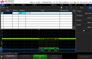

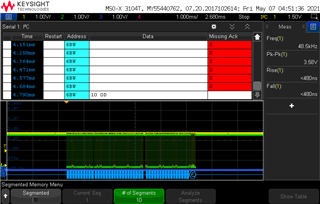

I am working on firmware for a customer's board and having some odd issues with I2C on the BQ25792. It appears that the device is busy and won't respond to I2C most of the time. I have a basic driver that reads the part information register to check if the chip is there, then a loop that resets the watchdog every 500ms.
About every other loop, the BQ25792 won't ack and takes many retries until it works.
Good transfer.
Bad transfer.

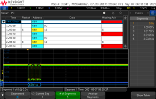

  • HI Alex,
    There are no known issues with the I2C engine for this device.  Have you tried using either the EV2400 and BQStudio software or USB2ANY box and online GUI for the BQ25792?  You can disable the WD timer.
    Jeff
  • Hi Jeff. I am seeing the same behavior when hooked up to the EV2400 and BQstudio.
