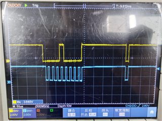

Hi:
I have try to use the subcommand read DEVICE_NUMBER - 0x0001 with iic , but the iic communication is  unstable.
The bq76942 do not answer the ACK  In most cases.
The screenshot of my oscilloscope is shown below:
I try to send device address 0x10 to the bq76942,but there is no ACK send to me.
But sometimes the  76542 will give back the ACK signal of the command.
Anyway, this chip's ACK signal is Very unstable, The chip is so unstable that I can't complete a iic communication.
Is there anything wrong with my wavefrom?  If not, What else needs to be done?
Dose this chip has a IIC clock strech function?

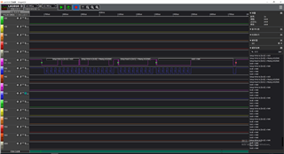

  • I try to use the same MCU and same code to control bq76952 with iic interface.
    Communication is stable, bq76952 can provide ACK signal stably.
    A screenshot of the logic analyzer is shown below.
    Is there some different between the bq76952 and bq76942?
    Or is there some unknown problem with my bq76942?
  • Hi Tan,
    These 2 devices should behave exactly the same. The I2C is identical for both devices. Maybe there was something unstable or noisy in your first setup?
    Matt
