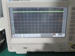

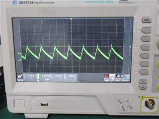

The pins 1, 5, 6, 7, 8, 9 and 10 of the old PCB version that can work normally are all high level in different degrees (pins 1 and 5 are high 5V level, and other pins are 2.5V level),
The ripples of these pins in new PCB version that cannot work properly are shown in the attachment.
[P1 Vref ripple]
[P5 SS/EN ripple]

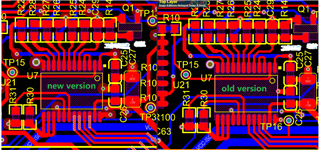

The schematic diagram and PCB layout of the new and old PCB boards are the same,
[Schematic]
[PCB compare]

    If your SS pin is cycling more than likely the design has an OCP fault or something is loading down the the SS pin.
    I would start by studying the voltage amplifier output, CS, SS, Vout and VDD.  Evaluating this pin should help you determine what is going on and how to fix.
    It also seems like the customer had one version of there design working.  You might want to ask them what changed between versions of the design.
