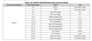

BQ76952: Table 4-5. 0x0075 DASTATUS5() Subcommand discrepancies
Part Number: BQ76952
/resized-image/__size/320x240/__key/communityserver-discussions-components-files/196/pastedimage1620413839592v1.png
Few questions regarding this:
  • The table mention Avg Cell Temperature in 10-11 byte and 18-19 byte. Are they duplicate?
  • If I have TS1 and TS2 set to cell temperature, where is the Min and max temperature obtained from ?
  • Is the min and max temperature over the a period of time, or is it min and max temperature among the different thermistors?
  • I have set the Vcell mode correctly, for a 6S configuration, but Min Cell Voltage (6-7 byte) and Max Cell Voltage(4-5 byte) does not correspond to the right min and max cells of the pack. What am I missing here?

    Yes, the Avg Cell Temperature is shown twice in this register. The reported values are the min/max temperatures at the moment - it is not over a time period. Are you reading something unexpected?
    The Min Cell Voltage and Max Cell Voltage should correspond to the min and max cells of the pack. Can you show the data that shows you are not seeing the expected values? What are your cell voltage readings and your min/max readings?
