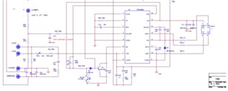

Details :  Our company applies this part to 3 applications. However, we detect that 2 out 3 is showing abnormal rising time.
               Under 15A Voltage, It takes too much rising time particularly within 5.8V - 6V (Abnoramlly slow rising time, 150ms)
               Under 0 or 50% Volage, It is measured as normal rising time (30ms)
               This symptom is not found on the parts made in this Jan, but found on the parts manufactured since this March.
               Approximately 10% of parts (produced after March) shows this symptom.
               What is causing this? What should we do to correct?

IC Peripheral Circuit
IC Pheripheral Circuit
    It looks the schematic is not clear, could you please upload a clear one? Thanks.
  • Here it is. Thanks for your effort.
    It's recommended simply connect SS pin to GND to get a constant soft-start time, it's not clear what's the extra circuit connecting to another device in SS used for but you can monitor voltage on SS pin to see if there is a proper rise. If not you should take a look at the extra circuit. Thanks.

  • Hi Brayden:
    Sorry that I did not describe it clear.
    I means the SS pin voltage, cause Vo(FB) should follow the SS PIN voltage to raise up. if there is some different, first step is we need check the SS pin voltage . My suspect is the leakage current at Q1 .

  • HI Brayden:
    In normal statues, the FB will follow soft start voltage raising, only see the soft start dc voltage is not helping for the root cause, as we mentioned , pls help show the SS PIN voltage waveform at start up.
    and in the same time, pls compare the COMP PIN waveform at start up see any difference. cause I also see external circuit adding at COMP pin .
    Did you tried to use TPS40056 EVM to verify the "bad" part and "good part" ,cause if EVM have same issue, it should be caused by silicon. if the start up perform same at EVM, then it is external circuit cause this issue.
