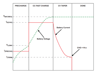

I'd like to know about the indicate about CHGpin.
Could you tell me the state when it becomes Low?
The datasheet said Low(for first charge cycle) at table3.
What does the first charge cycle mean?
Is it CC FAST CHARGE?

Hi Kengo,
The /CHG pin will go low when the device is charging. It will be high impedance if the device is not charging. As the /CHG pin is an open drain and so to see the states clearly requires a pull-up.
The fast charge portion of the battery charge profile would be where the charge current going into the battery is at its maxed and should be the current programmed at the ISET pin.
Anthony Pham
Hi Kengo,
Yes, the /CHG pin will be low in the precharge phase.
