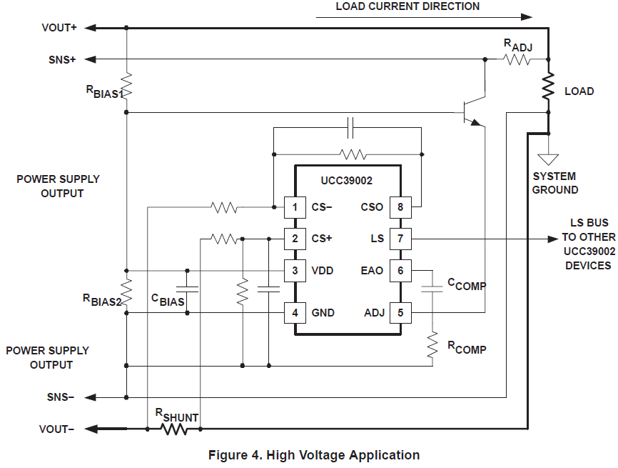

    I'm not getting put in share 2 power 2KW sync with the secondary (UCC28950).
    I can not share the work because I'm working 50V / 20A output.
    I have questions in the calculation of the resistors to set the gain due to high voltage (50V).
    Please help me.
    thank you
    Leonardo Souza
    lssouza@linear.com.br
  • Hello Mr Souza,
    Are you using the recommended high voltage circuit for high voltage outputs, in the data sheet.
    The base of the NPN is at a fixed DC level, so Iadj from pin 5 will be equal to the current in the collector that pulls on the RADJ.

    2. but more importantly, this design will have modules paralleled and use UCC29002 for share balancing.
        Power Modules with Synchronous Rectifiers do not work well when paralleled.
    In Paralleled power designs, one module will always want to be the Master because it's output voltage slightly higher naturally, due to many factors.
    See the attached Unitrode Seminar paper on Load Share for Paralleled Power
    4863.slup207 paralleling power.pdf
    The other parallel modules will want to put out a lower voltage, UCC29002 load share control attempts to force their outputs higher so they can contribute to the load.
    If Synchronous Rectifiers are used, the lower voltage modules (slaves) will try to sink current from the master, since the master Vout is higher.
    This will cause an extreme degradation of efficiency.
    You could use ORING diodes between the modues to prevent backflow of current.
    Or see the attached SLUA550 app note using a TPS2412 ORING controller to prevent current backflow.
    0726.ucc39002 with tps2412 oring controller slua550.pdf
    But the fact remains that modules with Synchronous Rectification must be handled very carefully.
