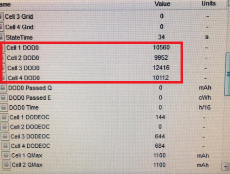

I'm using BQ40z50-R1 EVM to get 4-cell individual SOC information for battery balance, and I tried to read IIii to LLll (DOD0  cell 1 to 3) in ManufacturerAccess() 0x0074 GaugeStatus2.
Therefore, I can exactly know battery capacity SOC(1-DOD) instead of voltage if battery is LiFePo4. But I noticed the value is fixed (no change) on the GUI when 4-cell battery charging ,discharging and balancing.

  • The DOD values do not update very often. They typically only update when the cells are at rest and the voltages have stabilized to the point where they are changing at less than a 4uV/s rate. They are checked every 100s when at rest. The DOD points do not change when the pack is charging or discharging, although they can get set at charge termination. The DOD points are used for various features such as Qmax updates, setting the cell balancing time, etc.
