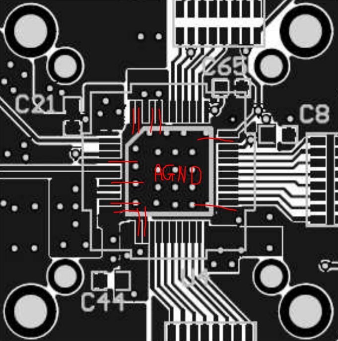

Over the past few years, we have had issues with ADS8406 going into latchup.  This is an existing design that has been in production for several years.
We had an independent lab perform failure analysis and were able to reproduce our symptoms.  They observed that raising the +VA supply from +5V to +6.32 V for 100 ns was enough to put the device into latchup. It matches our observations and internal tests.  After latchup, the devices draws approximately 500 mA (varies) from the +VA supply.
This seems odd, because the device has a maximum rating of +7 V on the +VA supply.
Can you help us determine why the device does into latchup while operating within the Absolute Maximum Ratings?

  • Hello Marten,
    There is one other condition where ABS max specs can be exceeded with less than +7V on the +VA pin.
    +VA to +VBD; ABS max range of -0.3V to 2.55V.
    If you are using a digital supply greater than 4.5V on +VBD, then the full -0.3V to 7V range on +VA will apply. However, if +VBD is at 3.3V, then the ABS max limit on +VA will be 3.3V+2.55V = 5.85V. Exceeding this limit can cause an internal latchup.
    Please confirm the voltage on +VBD when adjusting the +VA voltage.
    Keith N.

  • Hello Keith, thank you for the reply.
    We have +VBD at 3.3 volts. It seems that is what is happening, today I reproduced a latchup at +6 V.

  • Hi Marten,
    I looked at your original post, and see that there is a 10uH inductor between AGND and BDGND.  All of the ABS MAX specifications assume that AGND and BDGND are connected together using a low impedance ground near the device.  If these grounds are moving more than a few hundred mV's with respect to each other during a transient, this may cause a latch-up condition as well.
    Figure 2, page 10, for the ADS8406 EVM User's guide shows how the grounding was done for the evaluation board.
    http://www.ti.com/lit/ug/slau126a/slau126a.pdf
    Please make sure that the AGND and BDGND pins are connected together through a low impedance path near the device.
