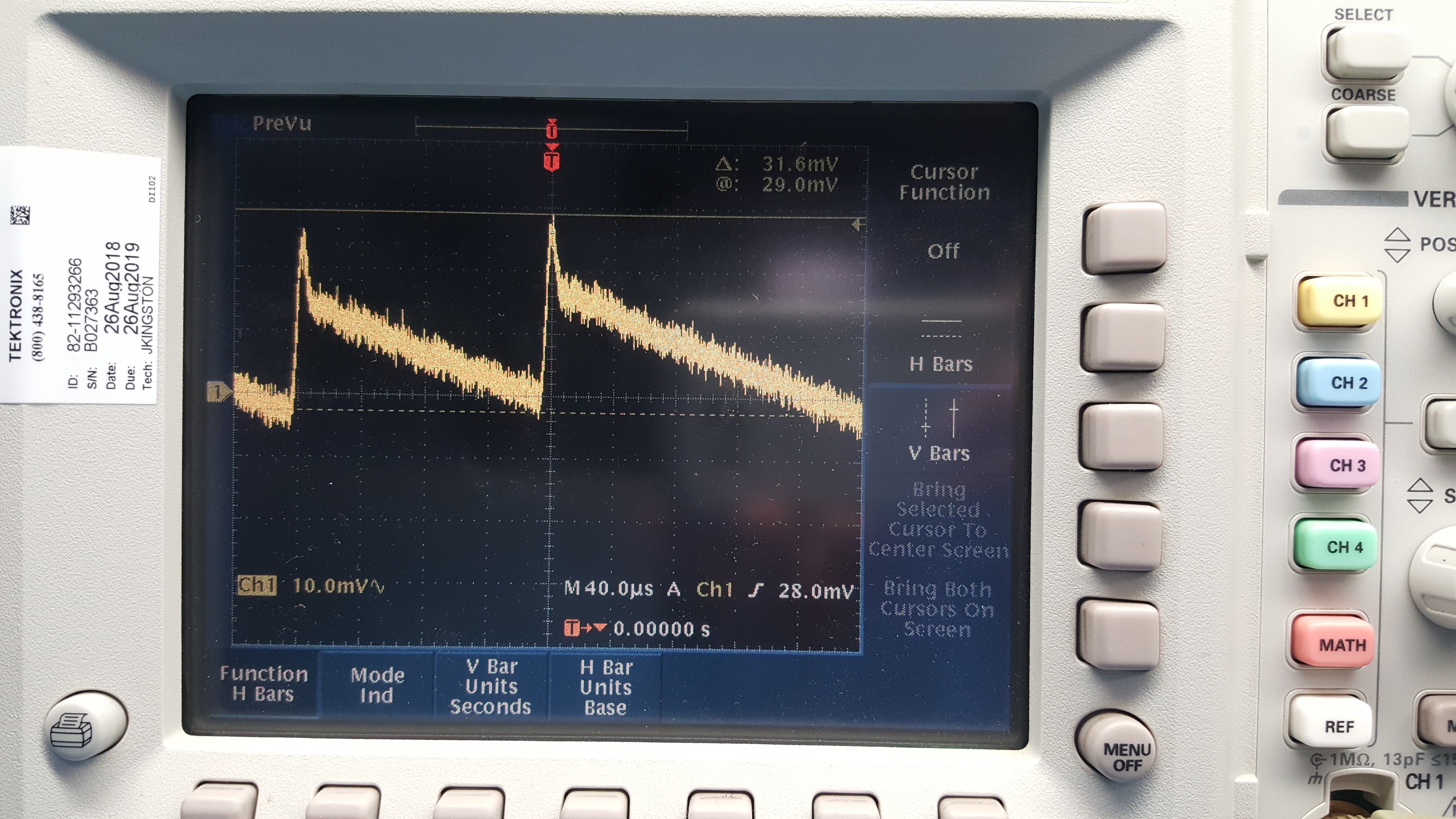

    Hi Taylor; Attached is the noise my client sees while the GUI is triggering conversions. Is this expected?
    Also, the attached GUI-generated spreadsheet shows 0's for AUX channels, yet each is tied to VIO through 20K's on the eval board? I believe it shows all channels enabled, but I've tasked them with resetting to 13 and retest.
    Attached is the image of the noise we got measuring across C40 (VDIG & GND). Previously, at address 7 (Command Oversampling) I had a value of 0x7D which does 32 sample averages and attached are the results of the log file. I can try writing a value of 0xFD to see if that makes a difference.

  •    Hi Roger and Taylor;
    Please see the attached captures. I'm really confused as to why there are ~2V glitches on OUT during sampling, since all channels are sitting at the same voltage, +/- a few millivolts??   Note jpg 101625 which captures the incoming command sent on Chan2, followed by the sequence of cell acquisitions at 60us intervals (sampling successive cells, not the same one)… See also jpg #102259 which shows OUT close up.
    Is this expected behavior?
  • Hi Jeff,
    I am assuming that your 1st plot is Vout.
    It's not glitches. It's level shifter output voltage.
    Check the 7.2 Functional block diagram.
    It goes to ADC MuX.
    Roger
