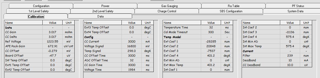

How to convert cc offset and borad offset of bq20z series from hexadecimal to floating point value
They are 2 byte data formats. So use it per that. You will not need this conversion if you use bqevsw. I don't know your part, so you can try both conversion styles and see which one fits. None of the AFE parameters are meant to be changed by you. You only need to change board offset and cc offset, cc gain and cc delta.
