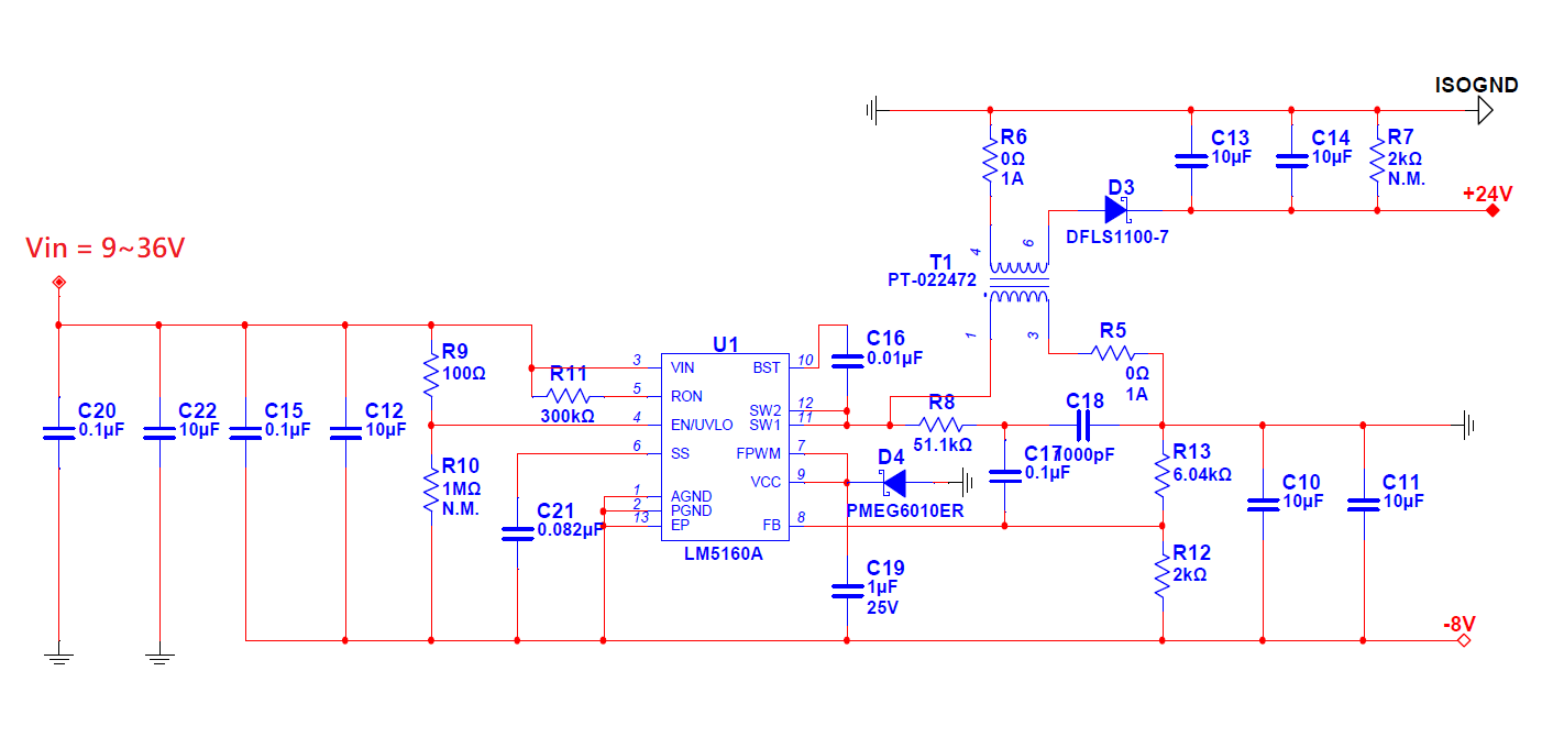

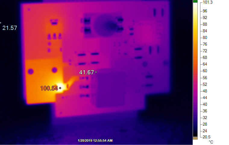

We use LM5160A for flybuck. The input is 9~36VDC and output is 24V. There is a problem is that when the input over 30V, the diode D3 temperature is very high.
Do you have any recommend?
Output: 24V / 35mA

We try GT20200 (Schottky Diode 2A, 200V). The temperature < 50°C. Excellent !!
