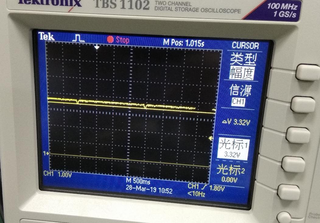

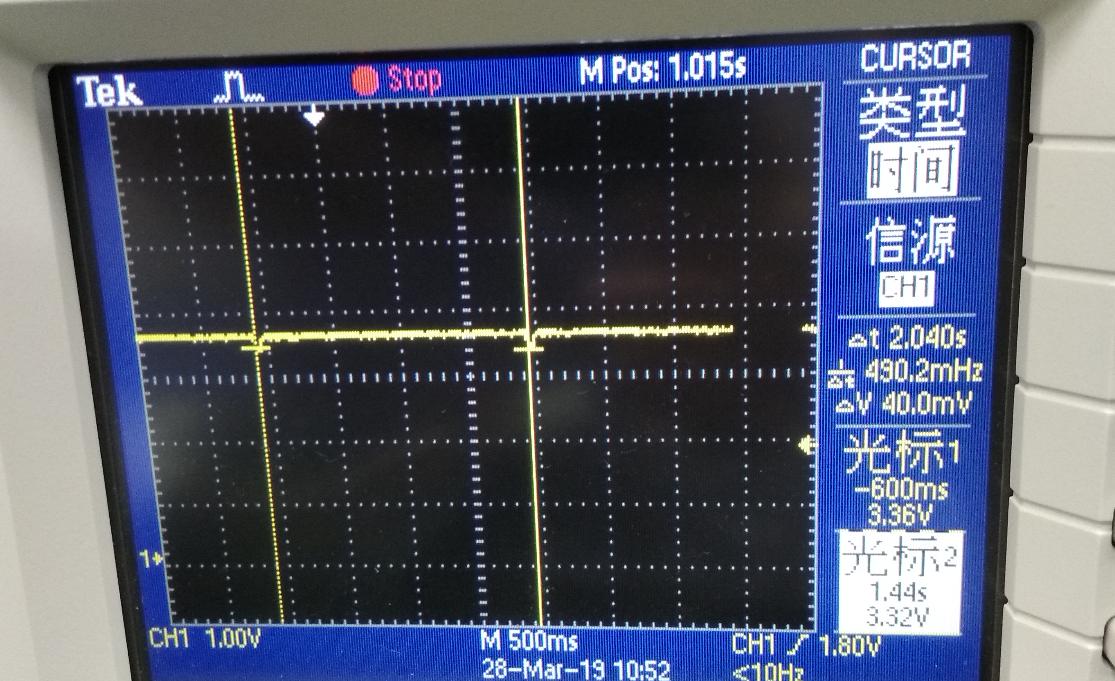

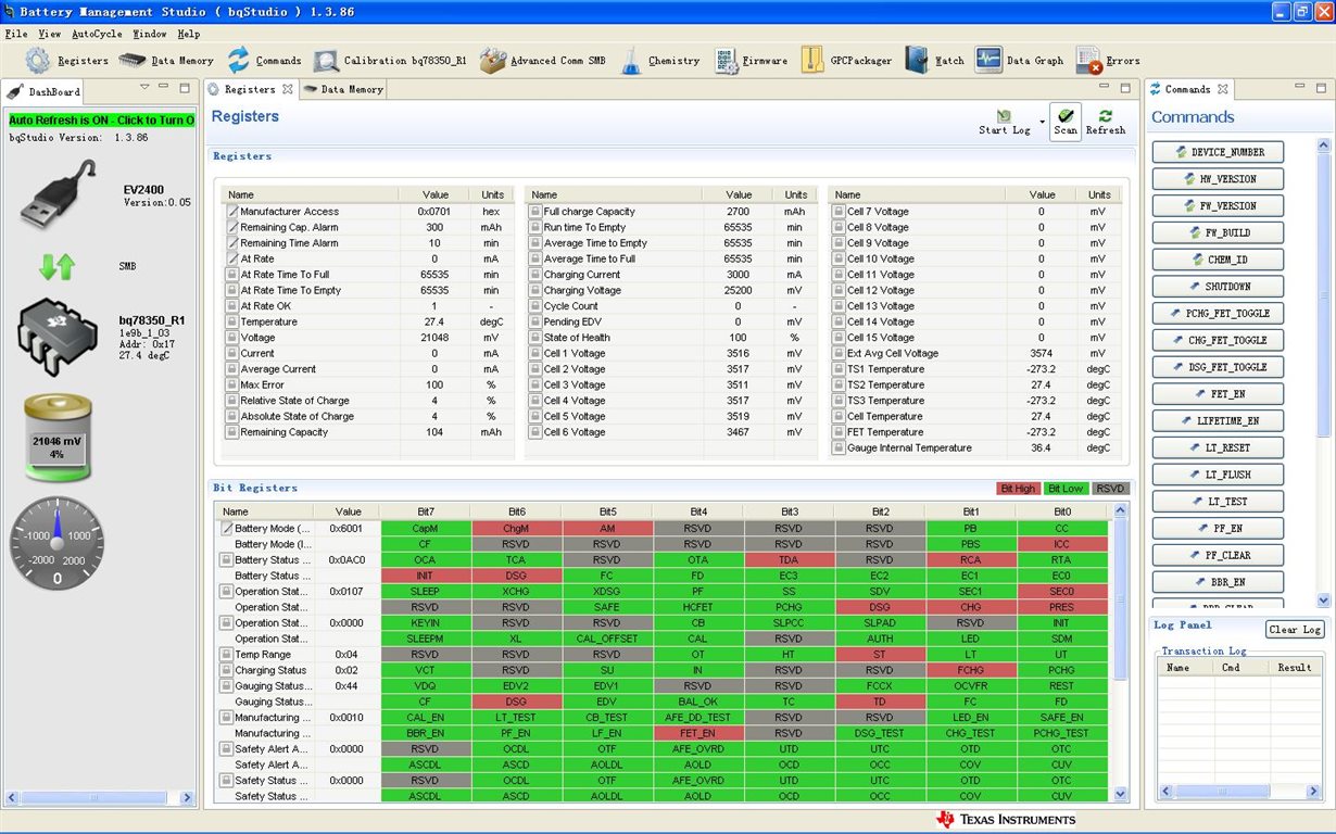

I have made a BMS made up of BQ76930+BQ78350,which support 6 cells.
However, the voltage of cell6 is always changing from about 3426mV to 3468mV. The actual voltage of the cell 6 is 3520mv.
