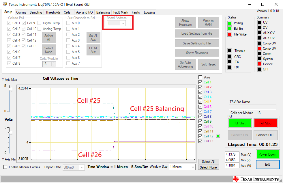

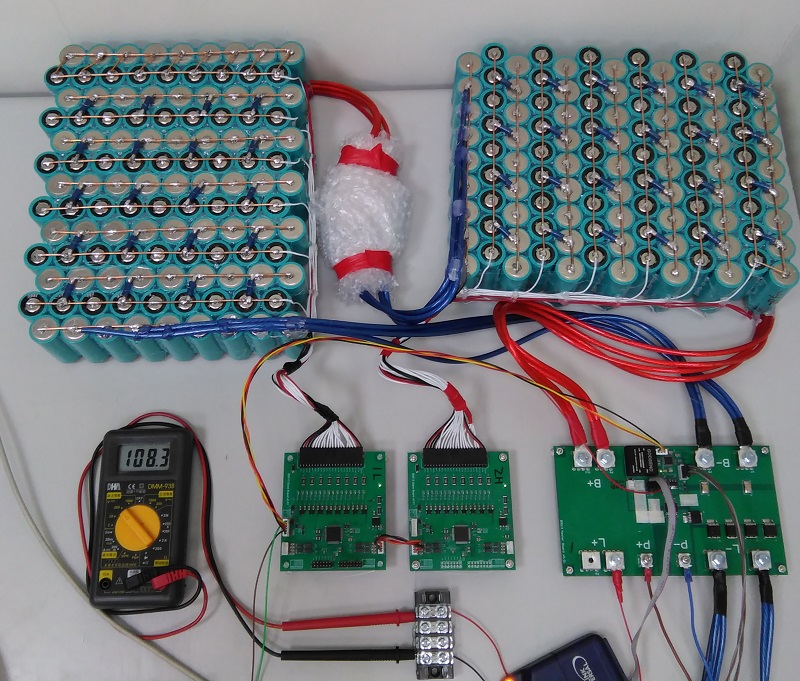

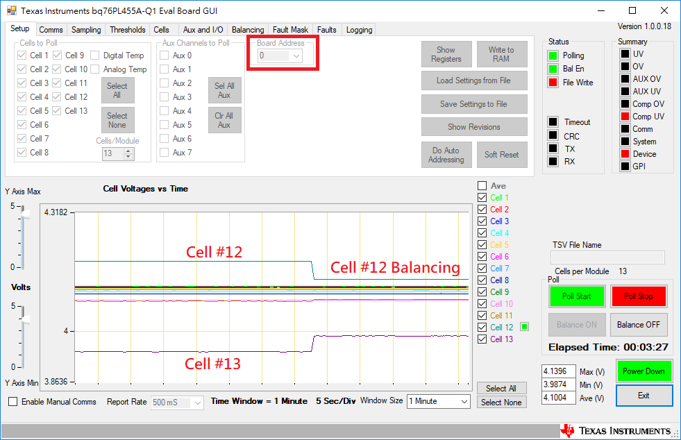

We use our own designed circuit board to manage 26-cell. Each board manage 13-cell.
We have a issue that is voltage of Cell #12 always higher then the actual value, and Cell #13 always lower then the actual value.
Board #1 and board #2 are the same. Please see following picture.
Do you have any recommend?

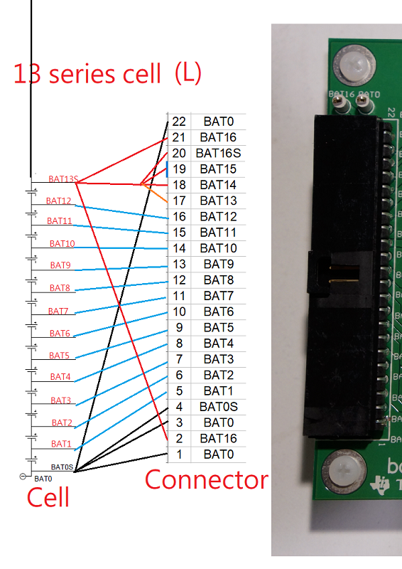

  • Hi Aaron,
    Can you explain how you connected the unused VC pins (i.e. 13 shorted to 14,15,16) and are you connecting actual cells or using a resistor divider to simulate the cells? Are you balancing during the times you see inaccurate measurements?
    Taylor
  • Hi Taylor,
    We were connect actual cells.
