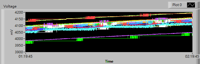

We are using BQ76PL455A-Q1 *2 for 26 series cell. The chart below shows the voltage(26 cells) of charging.
Why are some cells with a linear voltage, some of which are step-by-step?

Where did you get the waveform?
Is it from scope or is it MCU measurement?
It seems to me that you are plotting measurements.
Is there waveform from cell side? If not then please capture the waveform on cell side.
thanks
Roger

It is from the MCU.
What instrument do you prefer to measure the voltage of cell side? We have multi-meter and 2 channels oscillator-scope.
Aaron

We have to determine whether plot is real or not.
Are you charging or discharging when you are plotting?
The best way is use scope, not a meter, and see whether you see same waveforms.
Remember, there is a RC filter so you won't get the exact same waveform but you can see the pattern.
Another waveform you need check is after RC filter. This waveform should match your MCU waveform.
Am I making sense?
Once you have two waveforms then you can determine whether you have proper RC filter or not.
You can share the waveform then we can help you with the RC filter.

We are charging when we are plotting. The MCU read voltage of 26-cell from BQ76PL455A-Q1, then transmit to PC using UART to USB cable.
You can see the purple line & green line are different in my plot. The purple line step by 1mV. The green line step by 20mV. Why?
The board and battery are not in here. We can not measure the cell-side now.
