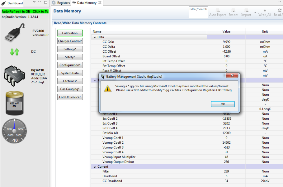

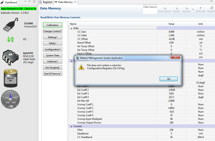

  • Hi Matt,
    Thanks for the reply.
    I have followed the procedure you explained and I have updated my parameters in Tab1 and I have copied Tab3 by saving it in .gg.csv file.
    But I'm getting an error message while importing that file. I have attached the screenshot of that. Also, I have attached our .gg file
    What may be the issue?

  • Hi Manoj,
    I am not sure what is causing this error, but here are a few suggestions:
    • The .gg file you attached is in .gg.xlsx format. The instructions say to copy and paste it into a text file (use a program like Notepad) and save it with the extension .gg.csv. If you save it in Excel, it may cause problems.
    • Make sure you are using the latest .bqz file for BQ34110. To do this, download the BQ34110 Firmware zip file from (http://www.ti.com/product/BQ34110/toolssoftware) and copy the .bqz file to this directory: C:\ti\BatteryManagementStudio\config
    • Use the latest version of BQStudio. From the BQStudio product folder (http://www.ti.com/tool/BQSTUDIO), download version 1.86.3. It is labeled as BQSTUDIOTEST, but it is the version that should be used. Sorry, I know this is confusing.
    I hope this helps,
    Matt

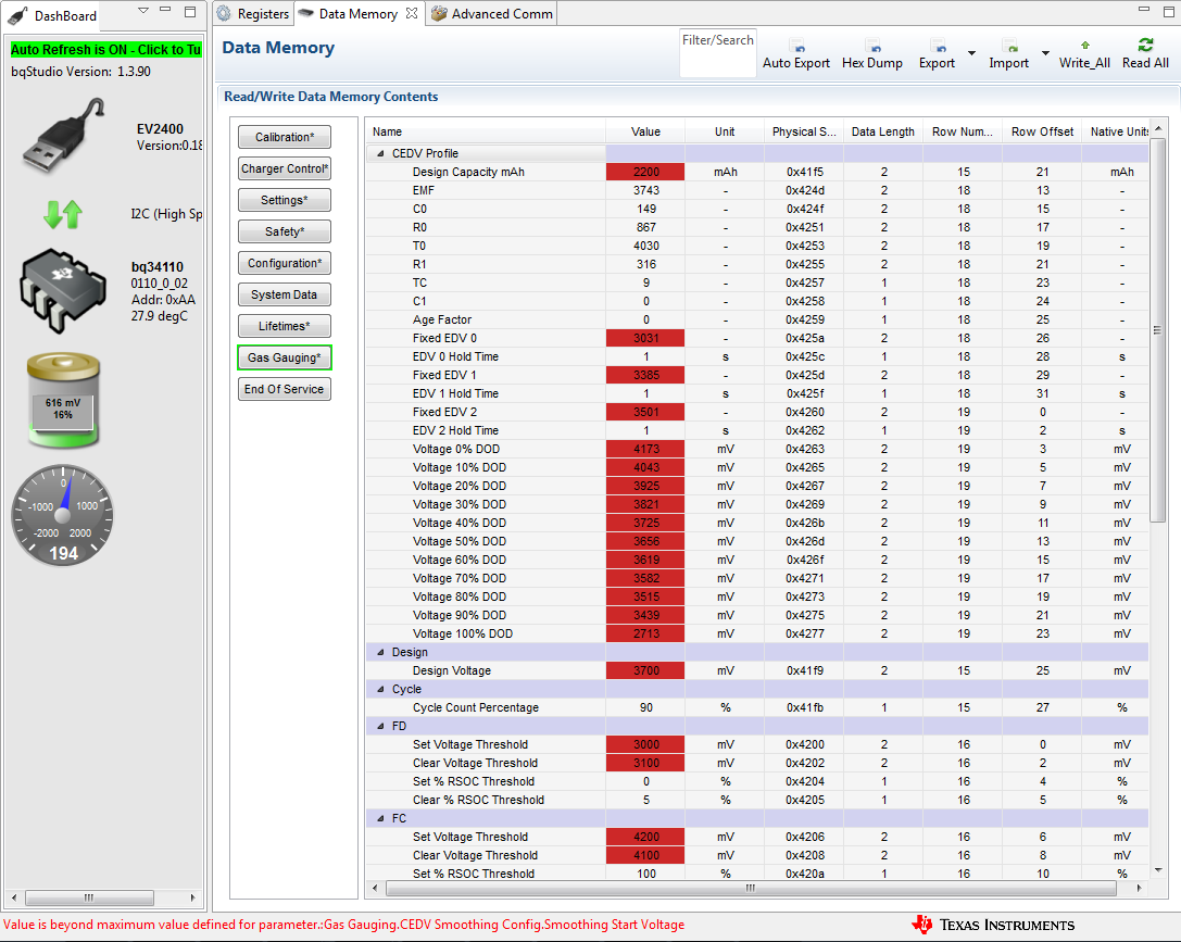

    3. Imported the .gg.csv file into Data Memory.
              3.1 Firstly, Imported the .gg.csv file. Got Error message as "Value is Beyond Maximum Value for Parameter Smoothing Start Voltage" (Value was 6000mV)
                    Then i have changed that to 3700mV. After that am not getting that error. What may be the reason?
              3.2 Then Again Imported the file. But in both the cases Only a few parameters are writing and most of the parameters are not writing and giving Error message as "No parameter matched address" every time.

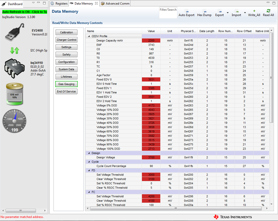

    4. Even tried writing Directly in BQSTUDIO -> Data Memory -> Gas Gauging -> Design Capacity. Showing Same error as above.

    We are using the same version of BQSTUDIOTEST. Still the same issue. :(
  • Hi Manoj,
    With the device in the unsealed full access state, write block 0x000F to 00 to enter ROM mode. Try to read 0x0D from address 0xAA and 0x16. The device should respond at 0x16.
    Go to the programming tab and reprogram the SREC to the device.
    Firmware should execute and the device should now be responding at 0xAA.
    In data memory, set flash update ok volt to 0. Read all to ensure the value is taken properly.
    From here, please reconfigure your settings.
    Sincerely,
    Bryan Kahler

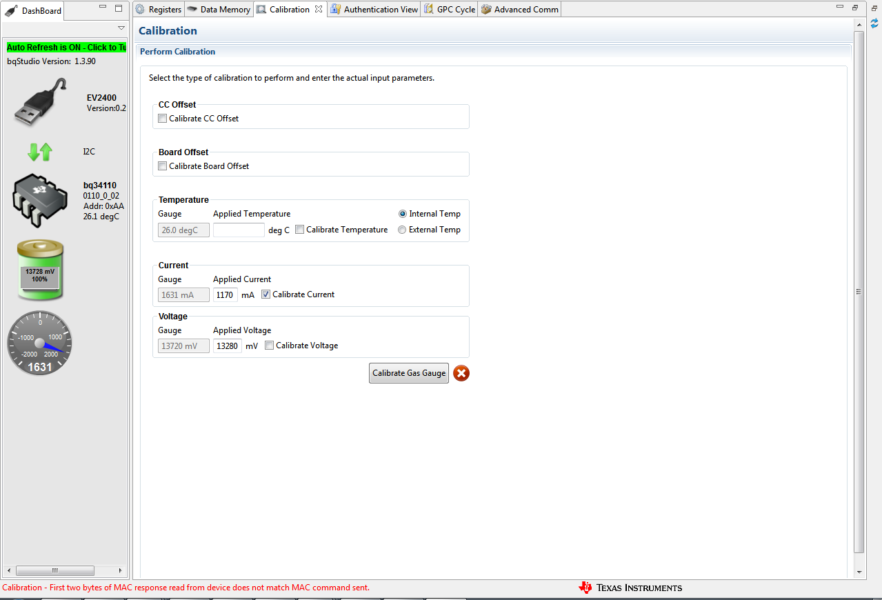

    Thanks for your suggestions. Now I can able to Write into the Data Flash.
    In calibration, CC offset, Board offset, Voltage calibration and Temperature calibration is done and calibrated properly.
    But we are facing problem while calibrating current. Below are the steps we followed to calibrate current.
    1. We put our battery pack for charging.
    2. Written measured charging current(through multimeter) in Applied current.
    once we perform calibrate gauge, BQSTUDIO is giving an error as "Calibration - First two bytes of MAC response read from device does not match MAC command sent."
    is anything missing in our calibration procedure? What may be the problem? Please suggest.
    Manoj S
  • Hi Manoj,
    Thank you for the screenshot - I haven't seen this issue before and will attempt replication in the lab.
    Could you please use a logic analyzer to record the commands sent and received?
    Sincerely,
    Bryan Kahler
