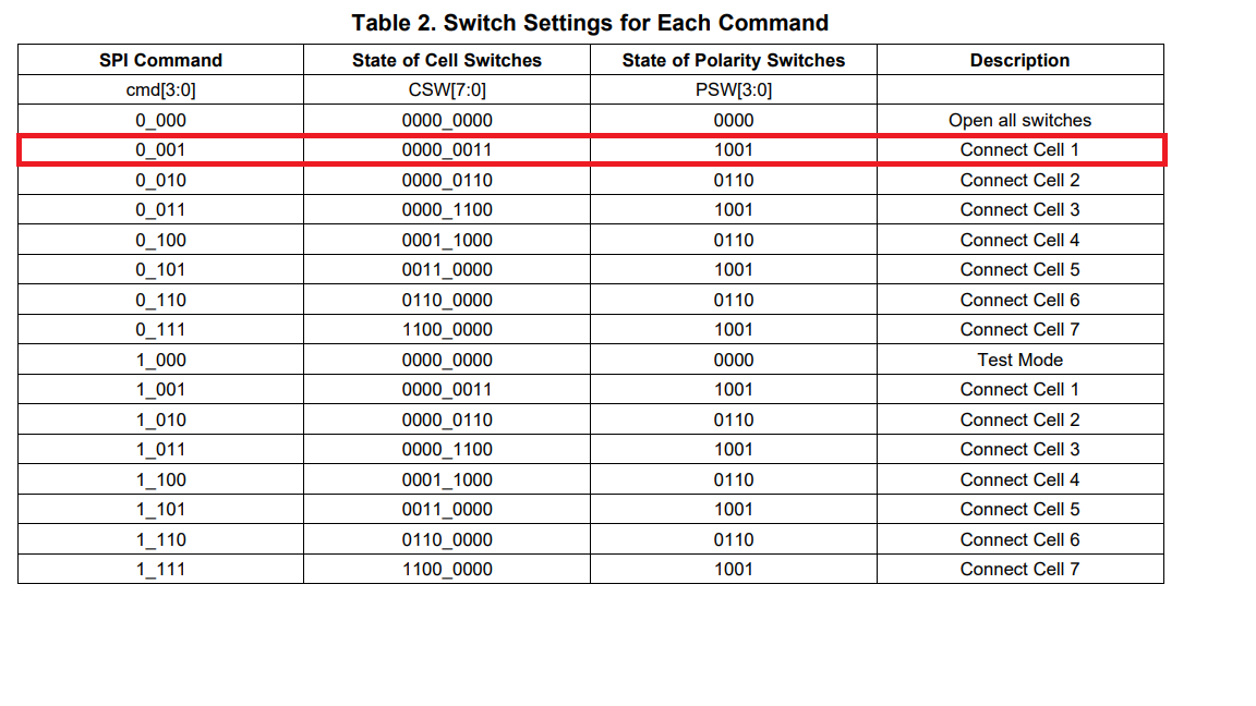

I currently using EMB1428 alone does not match EMB1499.

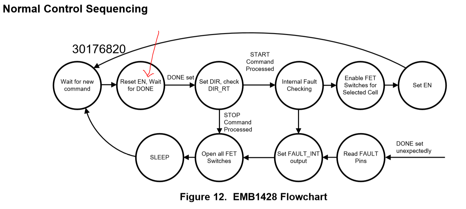

How to set EN ,DONE, DIR, DIR_RT these pins?
If it need to reverse,what should I do?
Is it a normal NOT gate or a specific one?
Does the official have a reference code?
I still have a problem.When I send 0x01 and the data receives fault[3:0] as 1010 is correct.
Can I see a waveform output between gate0 and sourse0?
I did not connect the MOS, just made a EMB1428 only board for testing charge pump and SPI and observe the reaction of the switch.
