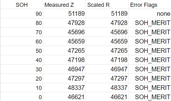

As mentioned in these forums, i tried the modifications and still the SOH drops in Max Delta.
Following are the tests performed with the changes mentioned in the above forums.
Setting the Cell Terminate Voltage to 900mV.
Turn on the gauge after the battery get relaxed to overcome the SOH_MERIT, SOH_ERR, or EOS_BAD_OCV flags.
SOH Max Delta is set to 10.

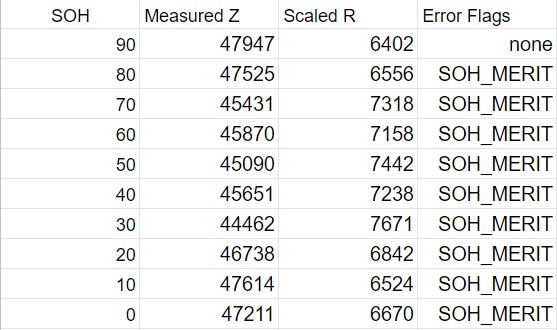

I have set the New Batt R Scale Delay to 10, where i did 10 cycles as follow.
Then i set the SOH in [Gas Gauging][Design][State of health] to 100% without giving the NEW_BATTERY command. And performed the test again as below.
But, still the SOH keeps reducing in each and every cycle by Max Delta.
