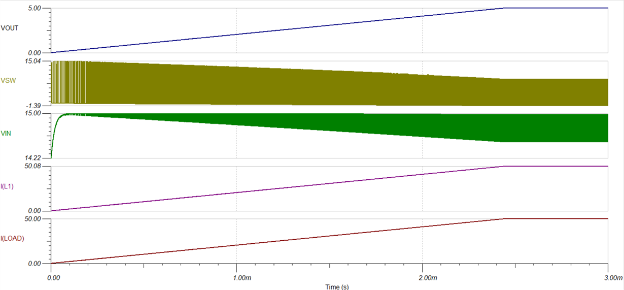

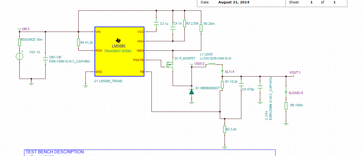

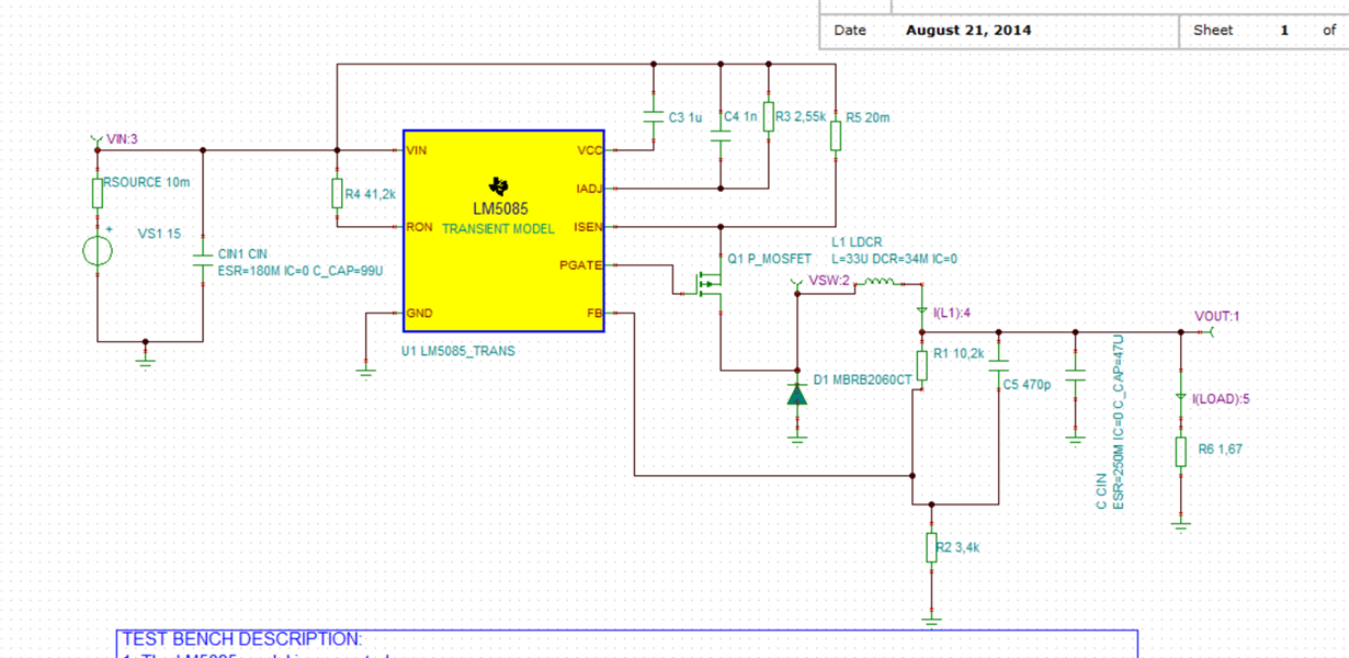

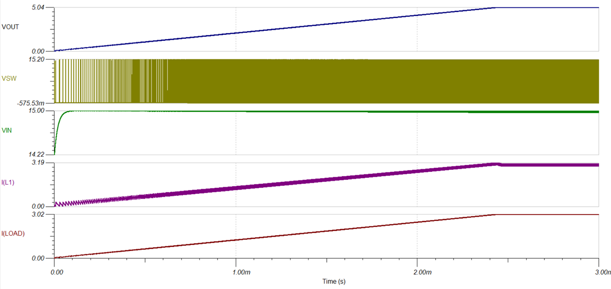

I am trying to simulate a design where LM5085 will be used primarily as a current limiter, i.e it will normaly be constant on. I cannot get the simulation to work neither in TINA nor in LTSpice. When I change the conditions so that LM5085 is regulating the output voltage (switching) the current limit works as expected. From the linked question I understand that there is some issue with the model. When will an updeted model be published?
