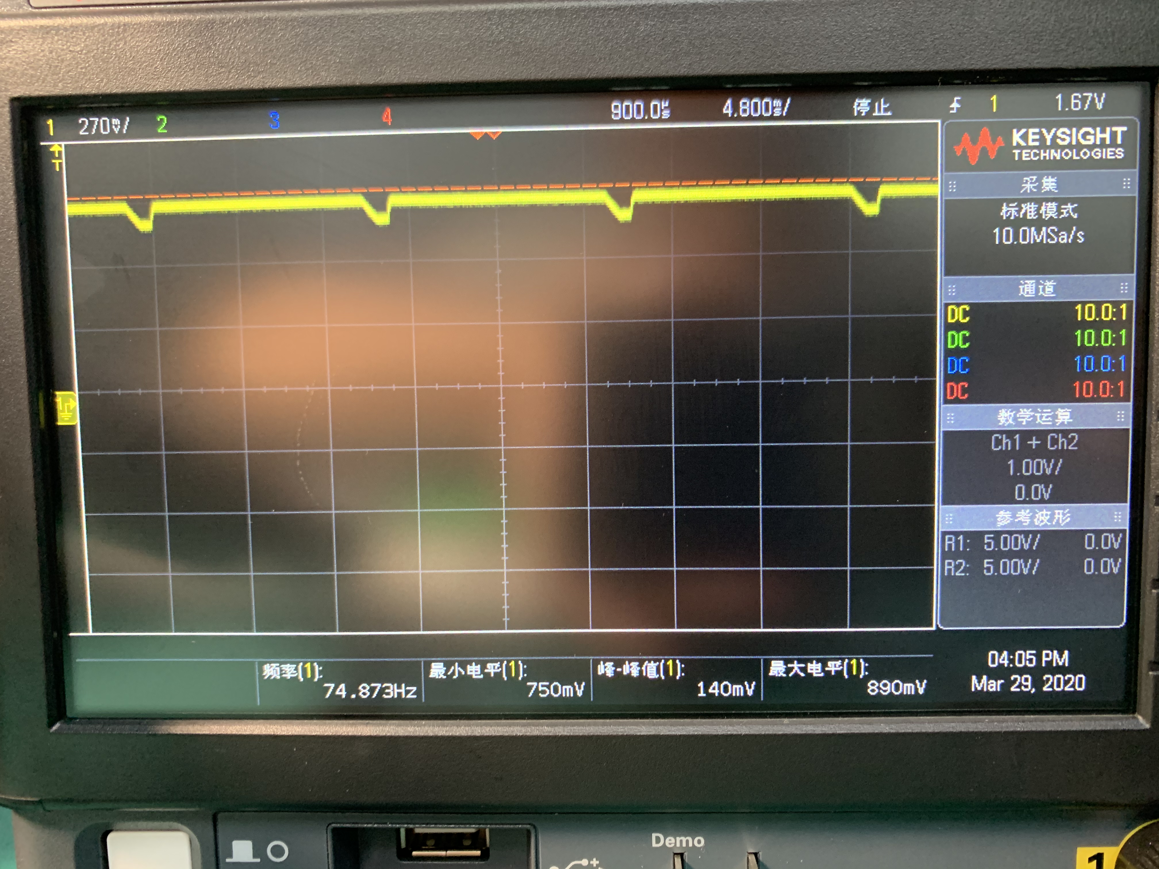

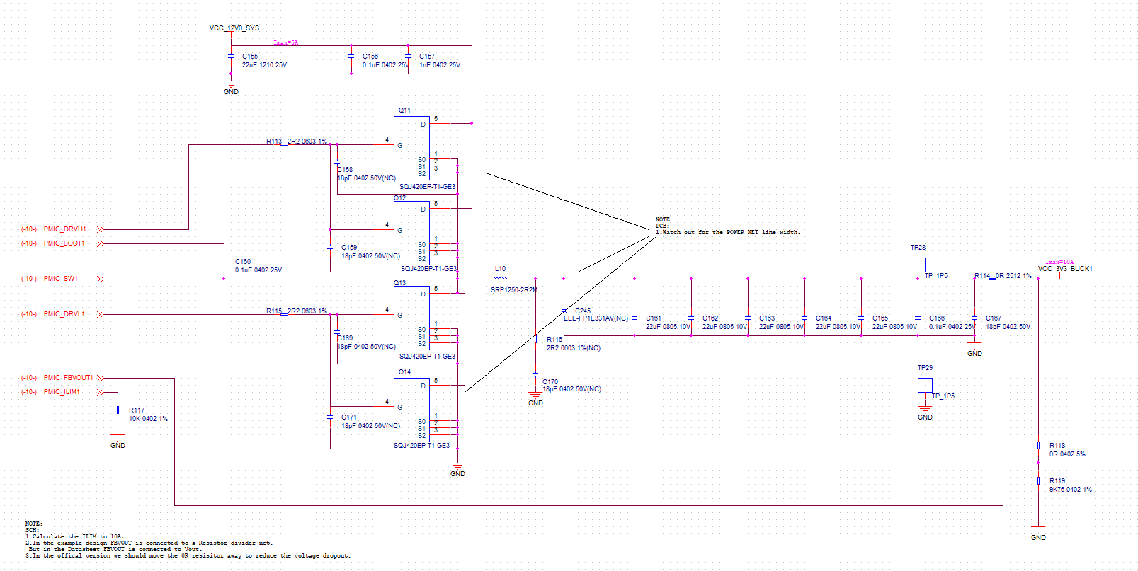

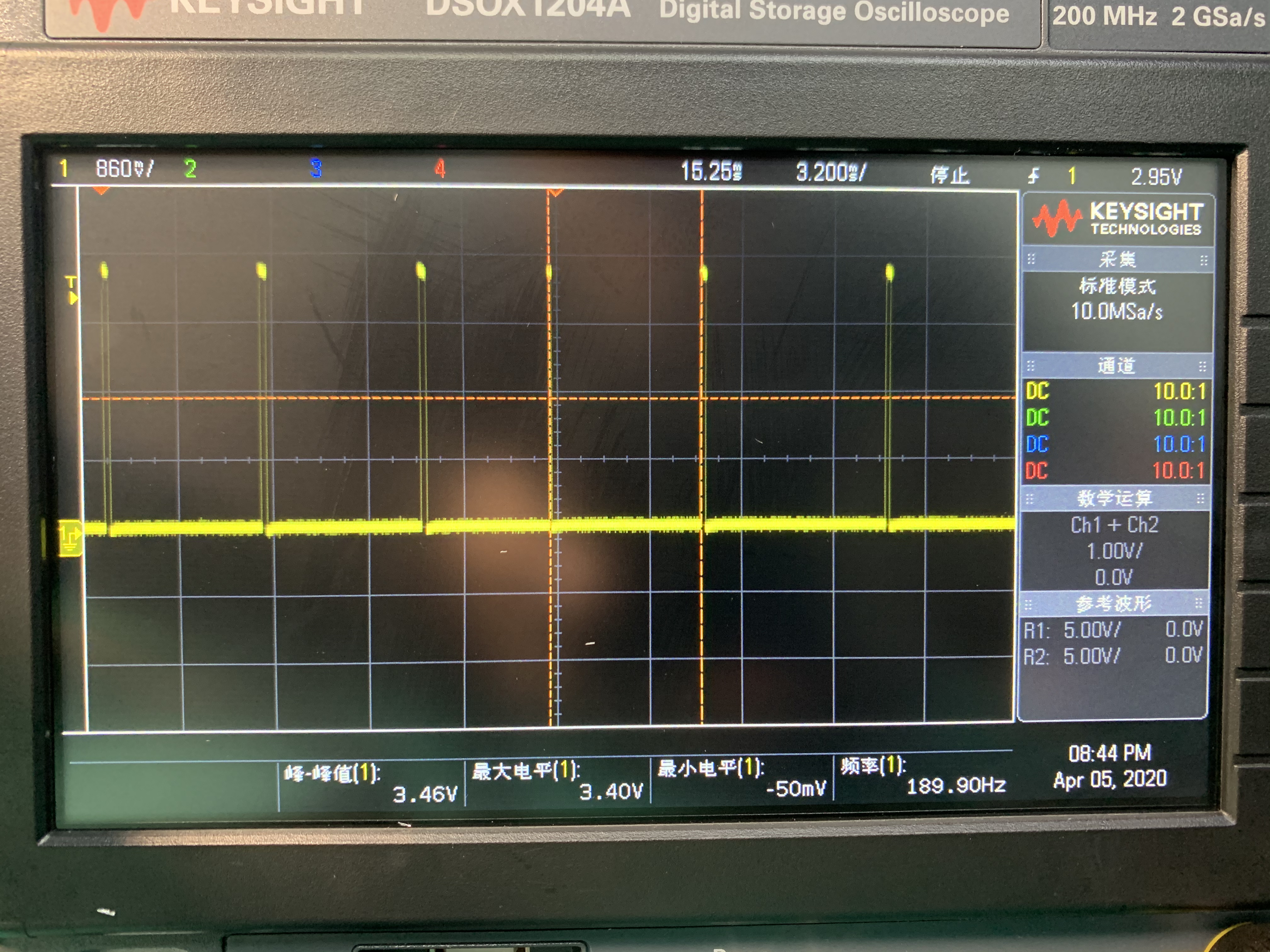

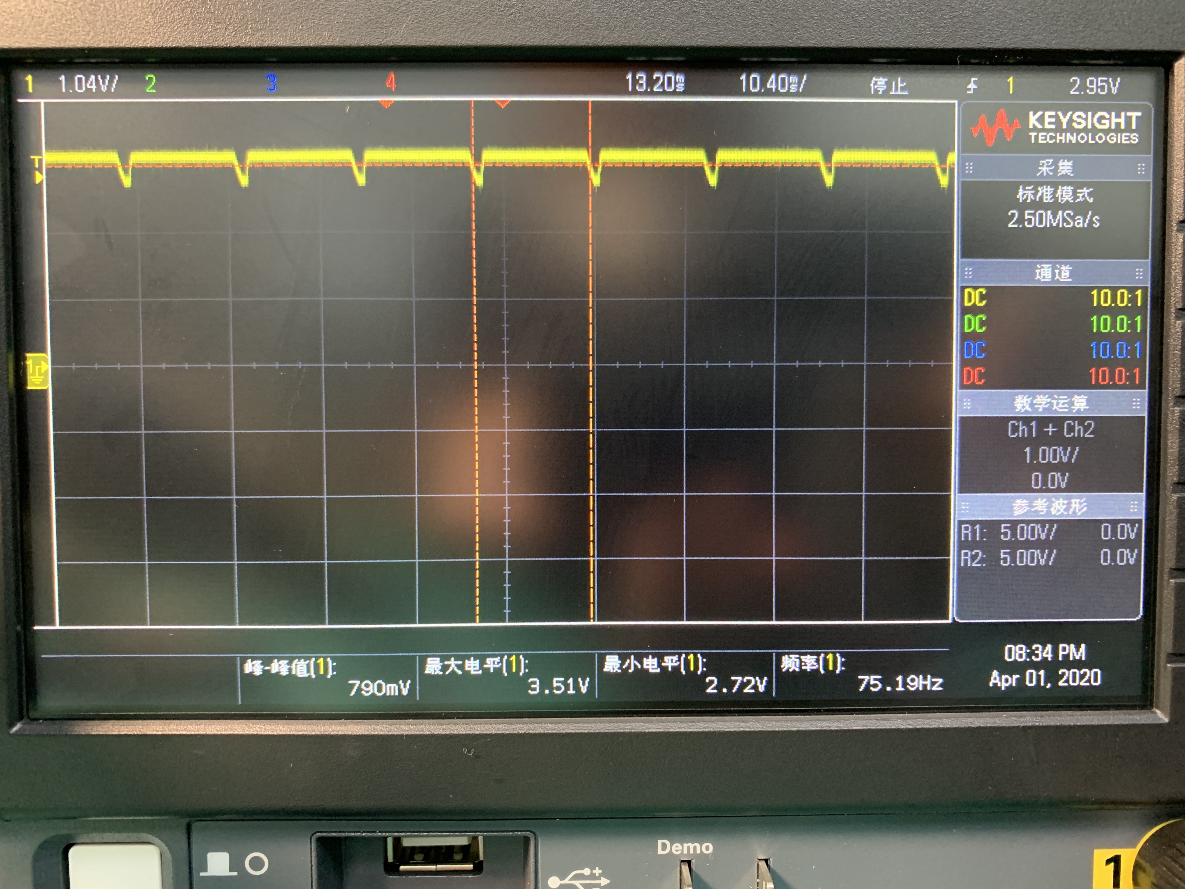

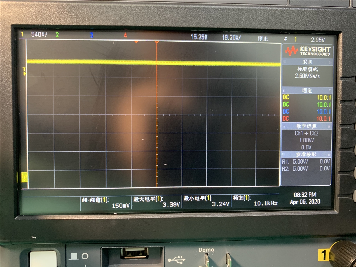

Hello, I designed a board with TPS6508640, with no load at all to test the design. But I can measured a 75 Hz wave in Buck 2 and Buck 1. And there are no output voltage in Buck3\4\5 whos' input are all buck1.
What's wrong with it? Is it because there is no load so there occurs the 75Hz ripple?

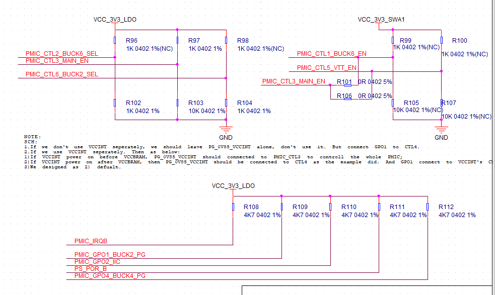

And this is part of my design below.

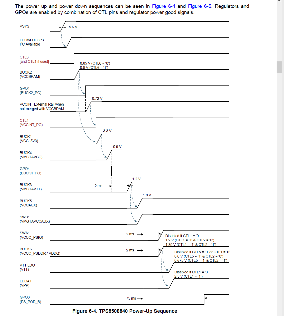

    That waveform looks like a power fault. There is a 10 ms mask on power faults, so if any rail of the part is not reaching power good within 10 ms, then the part will shut down.
    I recommend working through Figure 6-4 and figuring out where the sequence is stopping using an oscilloscope. If you get stuck, please post your sequencing oscilloscope shots.
    I started at CTL3, but looking at your schematic image, it looked to me like CTL3 is floating?

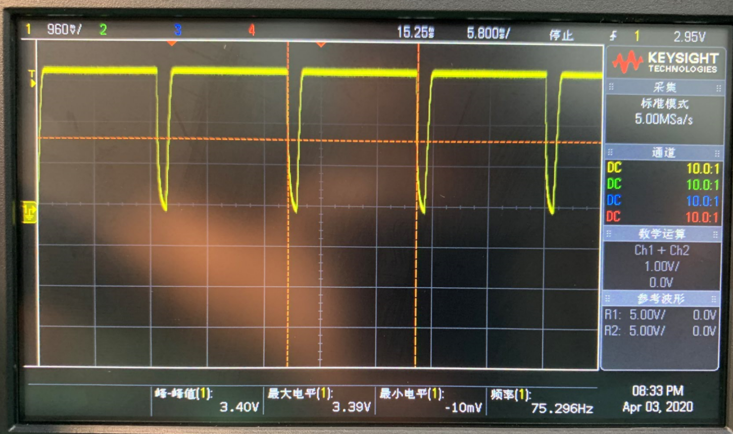

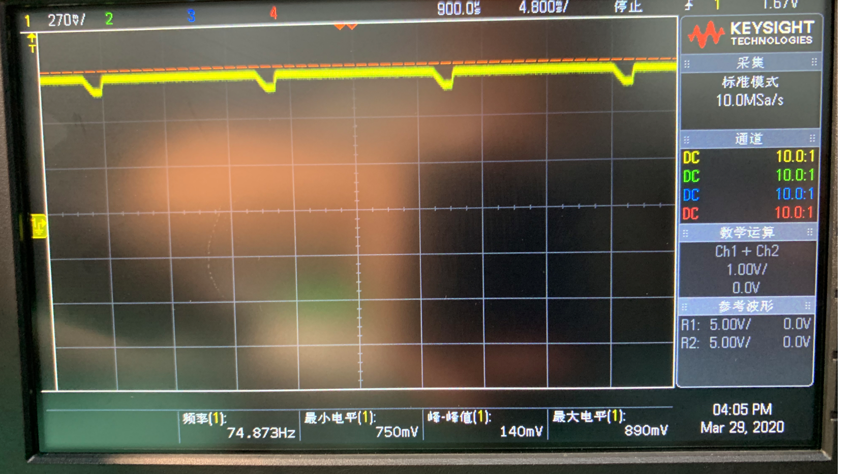

  • I pull-up CTL3 to LDO_3V3. It's not floating.  When I disconnect BUCK2_PG with CTL4(which is  BUCK1 EN ), the 75Hz waveform disappear. But if I connect CTL4 to 3V3 to enable BUCK1, the 75Hz waveform appears in BUCK2 and BUCK1.  and BUCK2's PG signal is also 75Hz.   As figure 6-4, BUCK4 output is not right with big ripples. and no output in buck3 and buck5.

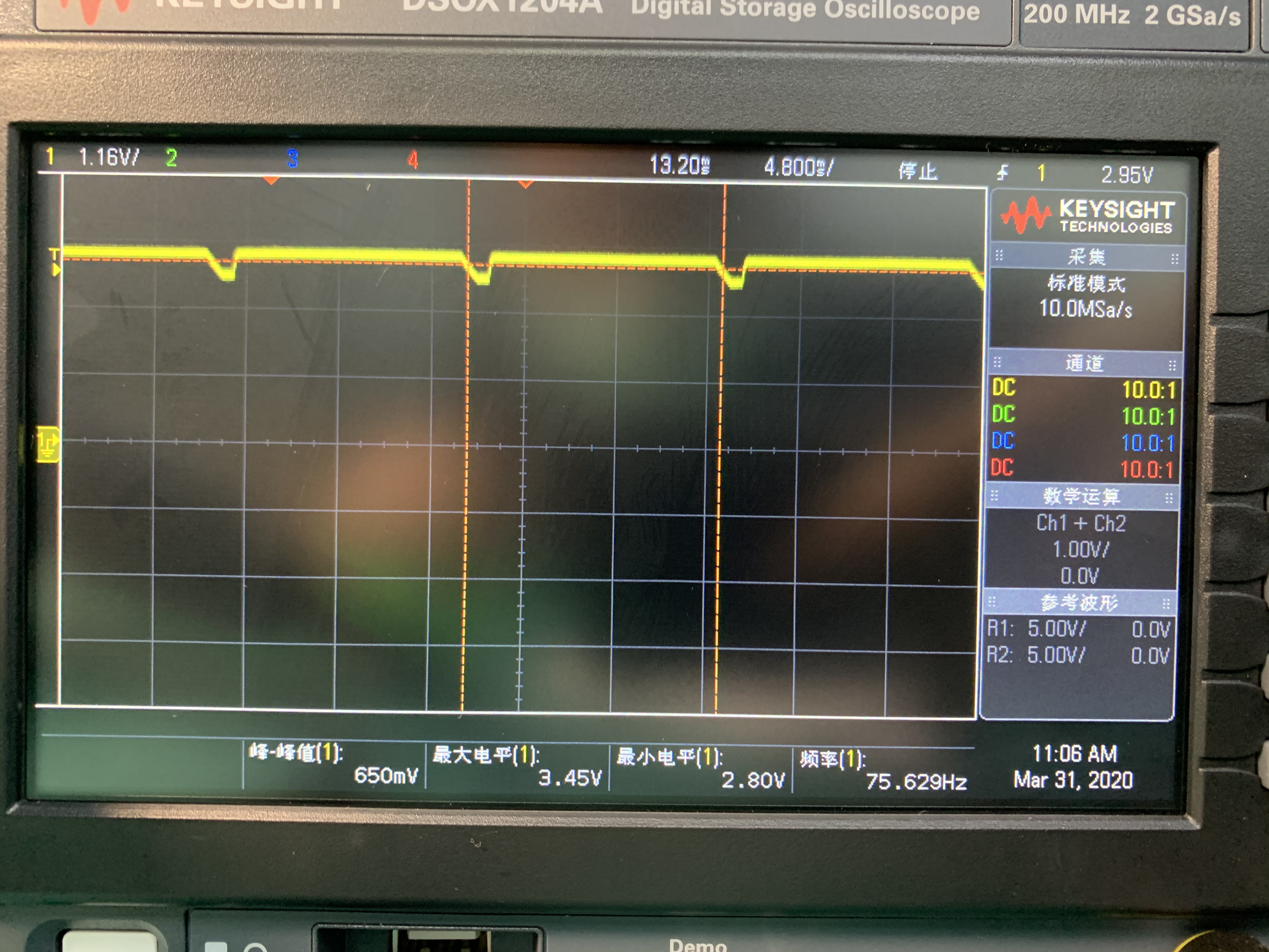

  • This is buck1 waveform.

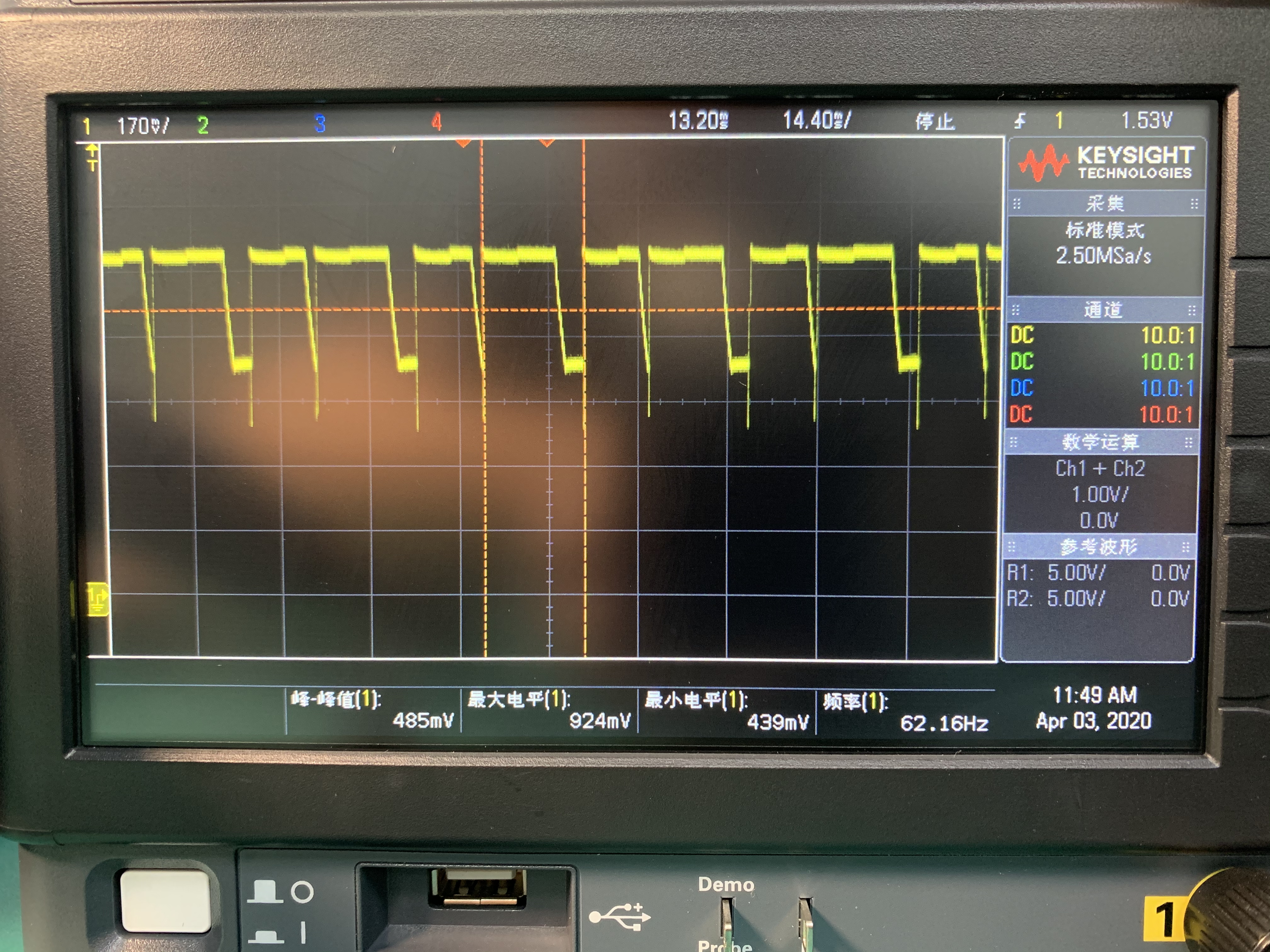

    This is buck4 waveform.
    Thank you for confirming CTL3 pullup. Not sure if R103 is intended to be populated, but should have no impact on the PMIC since 3V is still capable of enabling the digital.
    Regarding the waveforms, BUCK4 output certainly looks very abnormal. I looked back at the schematic and realized your inductor is 22 uH, not 220 nH. This converter is expecting 470 nH. Can you switch and see if the performance improves?
    If not, can you post the new scope shot, zoomed in to a single cycle? And please note how much capacitance total is on the output of BUCK4 in addition to the 44uF shown in the schematic as well.

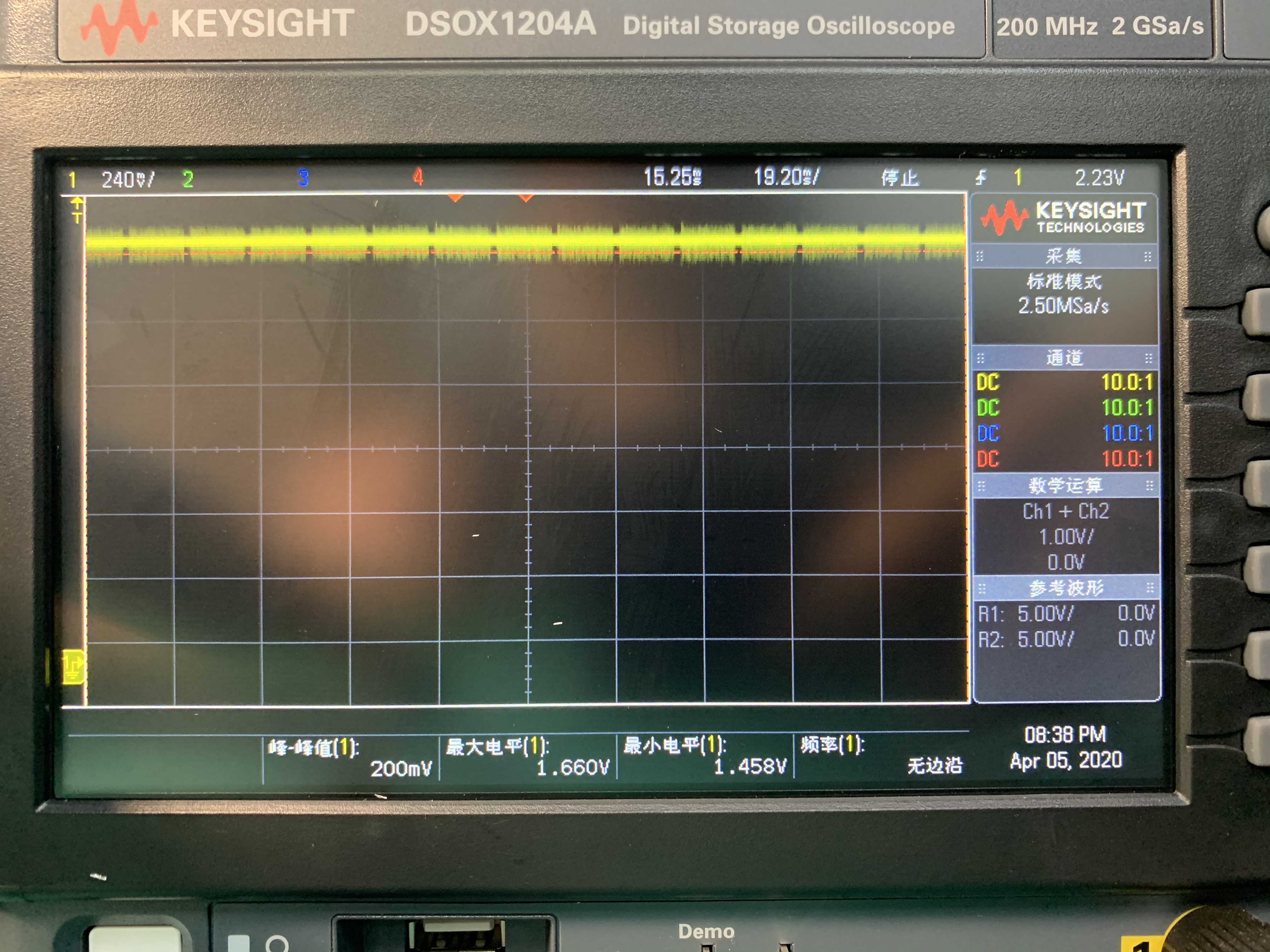

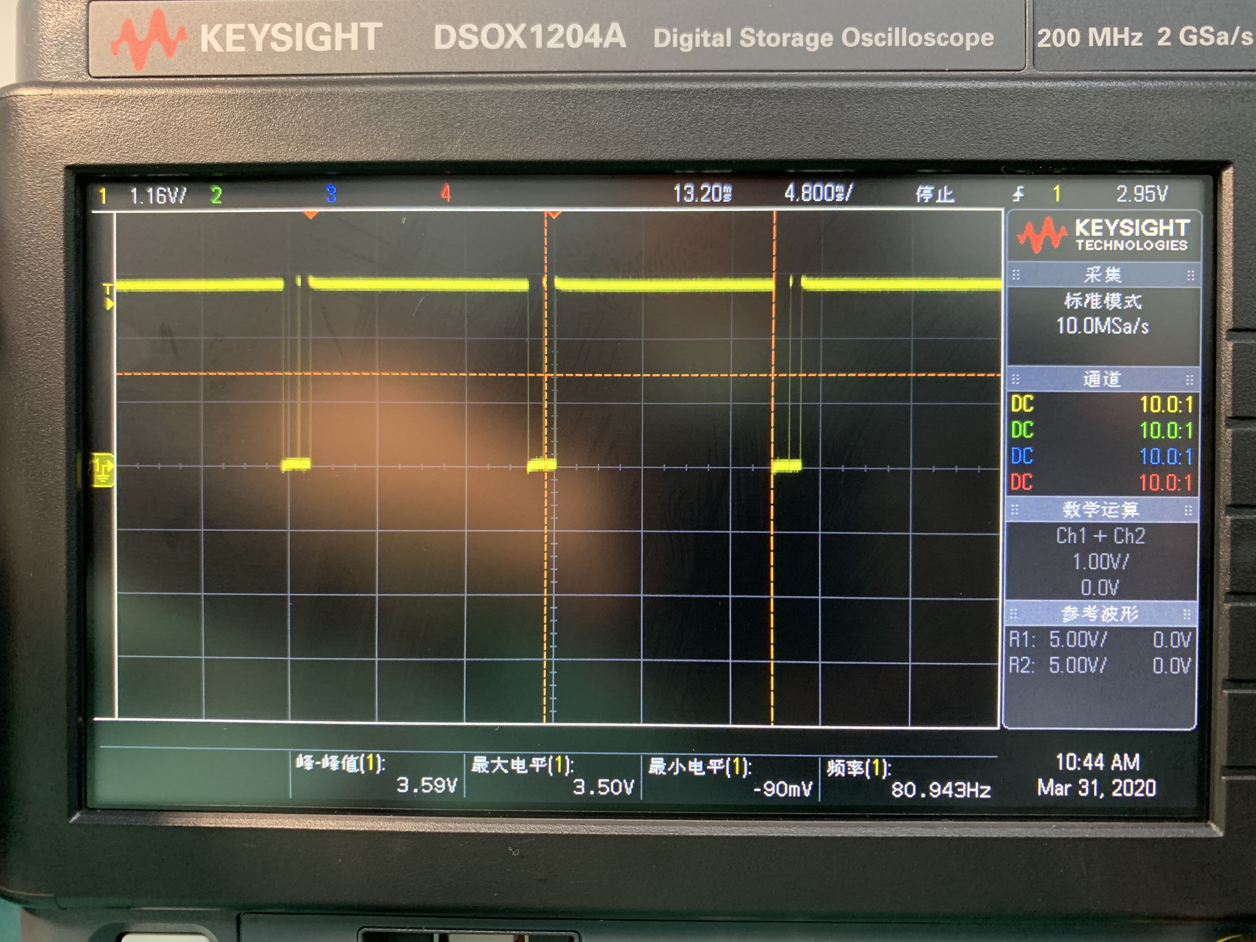

  • I have received my 1uH inductor, and replace the 22uH. Below is the BUCK4 waveform , it's somehow better but still unmormal.
  • Hi, it looks basically the same as BUCK1 now which is good; it turns on and then there is a power fault on any rail which causes the whole part to shut down.
    I would recommend continuing down the sequence trying to find a rail which does not turn on or turns on to the wrong voltage. Alternatively you could read the power fault registers by I2C to know exactly what the problem is.

    Looking at the scope shot, I estimate the value of BUCK4 out is 0.875 V instead of the target 0.9 V, but oscilloscopes are not always the best at giving the actual voltage. Can you post the layout of BUCK4?
