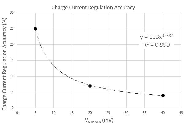

    And Customer created an approximate curve based on the following accuracy information.
    As a background, the customer wants to estimate the accuracy when "VSRP-SRN = 30mV".
    Is the idea of the graph below correct?
    Yusuke
  • Yusuke-san,
    "Fast charge is "VSRP-SRN = 40mV range".
    At that time, the precharge is "VSRP-SRN = 5mV range".
    In this case, Fast charge accuracy is 4% and the precharge accuracy is 25%."
    This understanding is correct.
    As for the curve the customer has created, it does provide a rough estimate and should be sufficient for their purposes. Please understand that this is not a warranty of performance.
