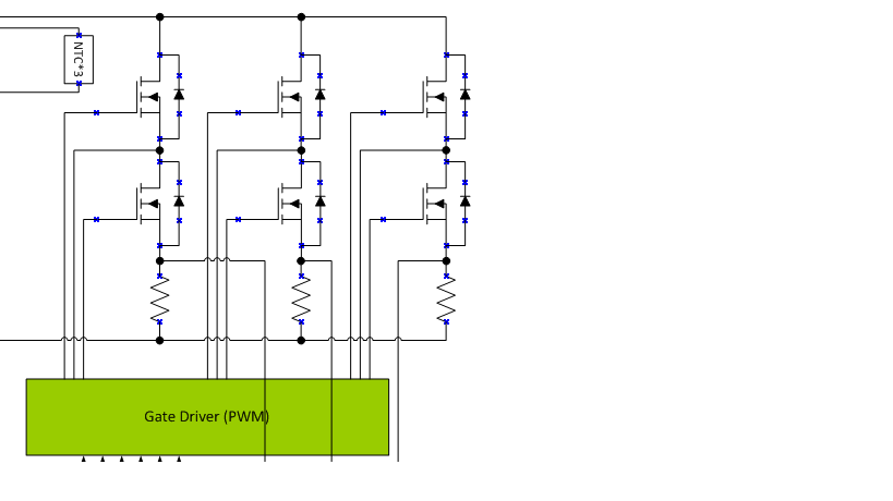

Below is customer topology that integrated shunt resistor. Do VSS and COM of gate driver need to connect together? Per datasheet description, low side has level shift so don't need connect together, right? Thank you.

Hello Patrik,
Your understanding is correct. There is a level shifter from VSS to COM which can handle -6V/5V. Here is a reference design you could take a look.
Here is a reference how you can process the sensed signal to EN.
Please let me know if you have any questions.
Wei

Hello Patrik,
Wei
