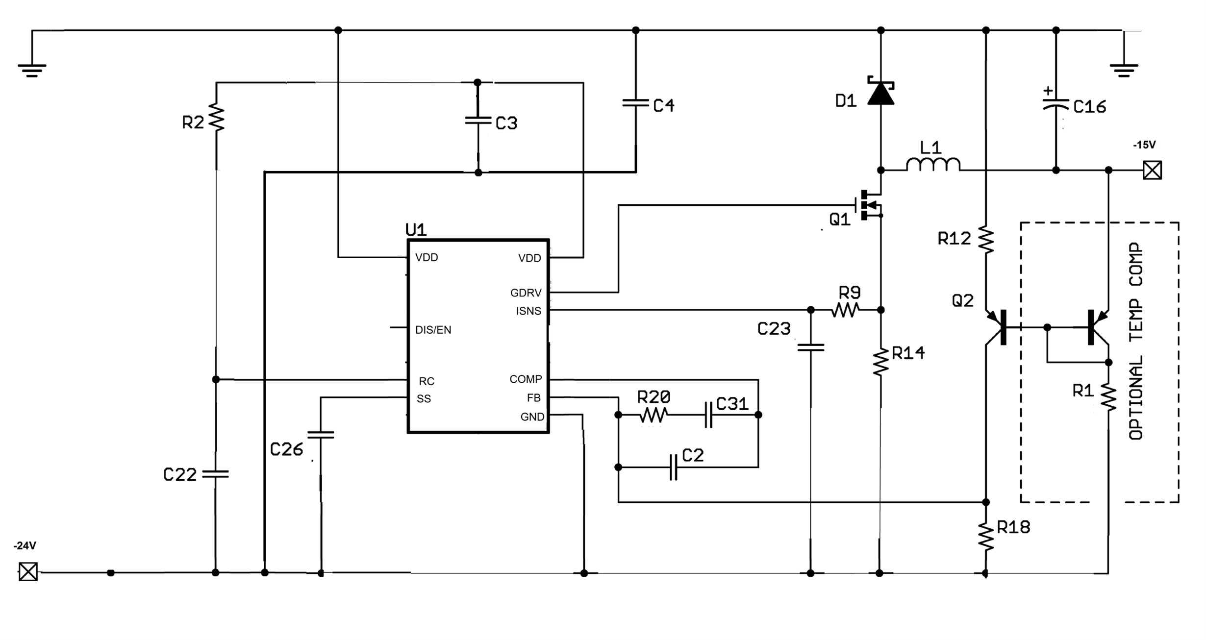

I am trying to  design a -24V to -15V switcher that can deliver up to 6A. Years ago Peter James Miller provided a topology which used the TPS40210 to generate a similar design but didn't provide any insight on how to calculate the R's and C's.
Also Webench does not accept negative input or output voltages for the TPS40210.
  • Hi Burt,
    What you mentioned must be a negative Buck, and the IC's GND reference pin should be tied to the input negative rail, as shown in the attached drawing, which I modified from an existing design with a different part.  The power stage (inductor, MOSFET, diode, and input/out cap, as well as current sense resistor) are calculated as the in a regular buck converter.  The Feedback needs level shift to sense the output voltage.   The feedback voltage is the voltage across R18, which has the same current as R12, and the R12 current is calculated by 15V/R12.  The pair npn bipolars cancels temperature coefficient of the effects of the npn BE junction.
    Hope this help.
    Youhao Xi, Applications Engineering

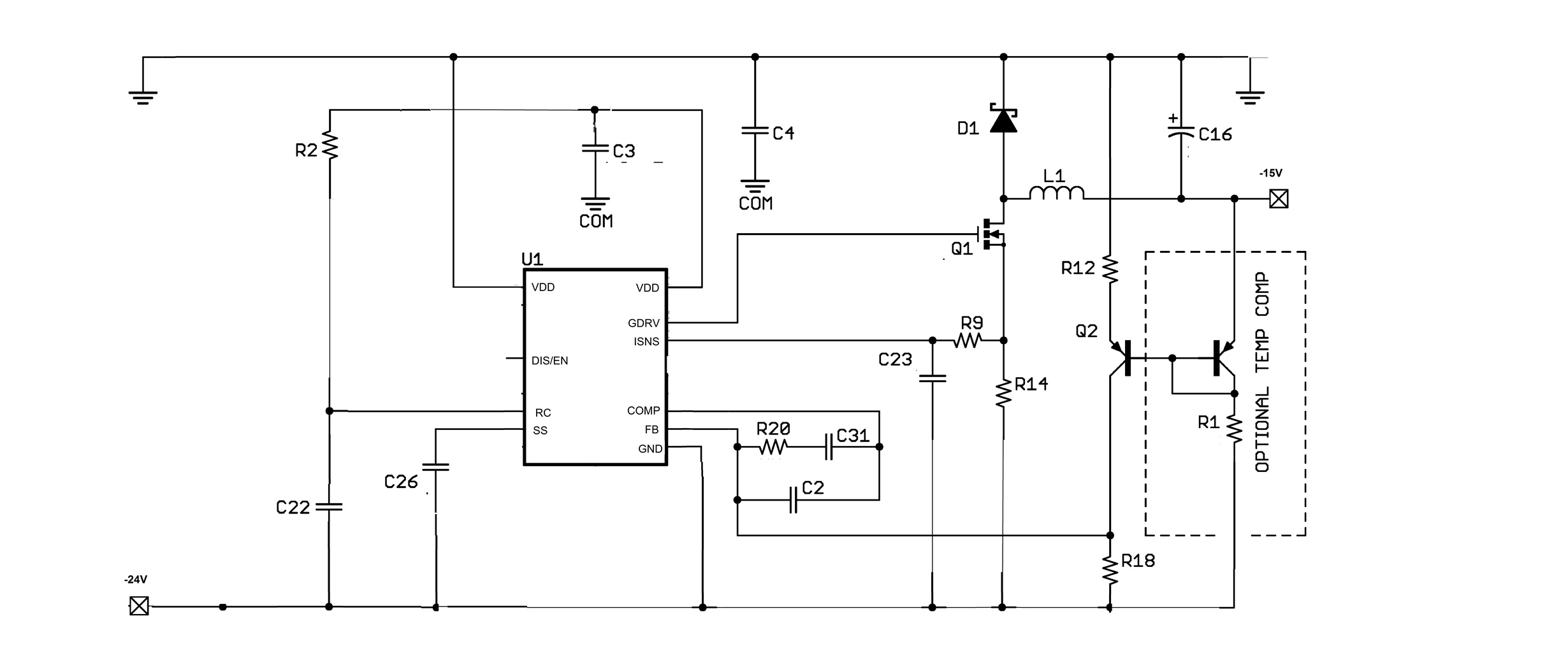

  • Hi Youhao,
    Yes, your answer helps, especially the part about calculating the rest of the values as a regular buck regulator.
    I am uncertain about some things still:
    1. What is "COM" in your schematic connected to? It looks like ground.
    2. I calculate Risns (R14) to be about 8mOhms. Is that about right?
    3. I have R2 = 200K to get 1Mhz switching frequency. This allows me to keep the L1 inductor to 6.8uH. Did I do this calc right?
    4. Peter James Miller in his original post from 2011 suggested an inverting opamp in place of the npn bipolars to generate the input to FB. I have a TLV172 with 4 resistors but don't know how to calculate what the resistor values should be.
    5. How should the FB resistor divider values be calculated?
    Burt Hashizume.

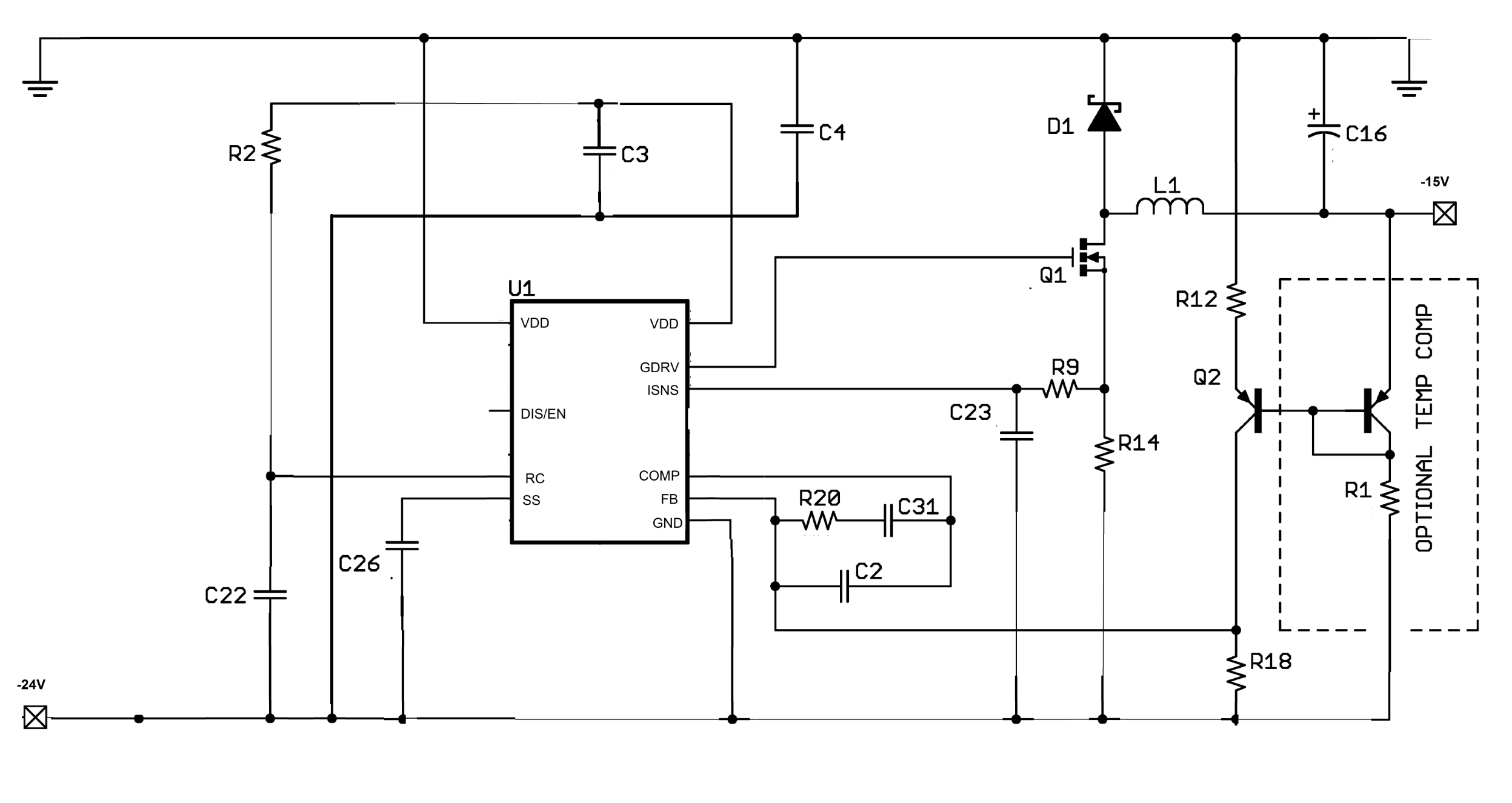

  • Hi Burt,
    Very sorry the drawing that I posted has errors that were leftover when I modified an existing drawing for you.  C3 and C4 should reference to the IC GND, or the -24V input rail in this case.   The COM GND symbols should be deleted. Here I attach an updated drawing.  Sorry for the confusion.
     (2)  How do you calculated it?  It is a buck converter and the inductor dc current should be the load current.  Under 1MHz 6.8uH, the ramp current is about 0.8A, leading to a peak inductor current of about 6.4A.  Then the current sense resistor should be about 16mOhm.
    (3) It should be okay if the timing capacitor is chosen to be 68pF according to the datatsheet frequency curve.  However, to me 1MHz is too fast for this 90W design.  You will not have good efficiency, given the fact that the circuit is hard switching. Recommend to reduce to below 400kHz.
    (4) I haven't see that suggestion.  We started to support the TPS40210 since Feb 2017.  The pair pnp transistors should be a simple way to perform the level shift Vout sensing.
    (5) It is very easy to select these resistors. Refer to above drawing, R18 and R12 see almost the same current, if the bipolar HFE is >>1.   The current through R12 is Vout/R12. The two PNPs just cancels the effects of Vbe and temp coeff of it.  The the VFB = R18 x (Vout /R12).  You need to choose these resistors such that VFB=Vref of the TPS40210 when Vout reaches the setting point of 15V.
    Hope this clarifies.
    Youhao
