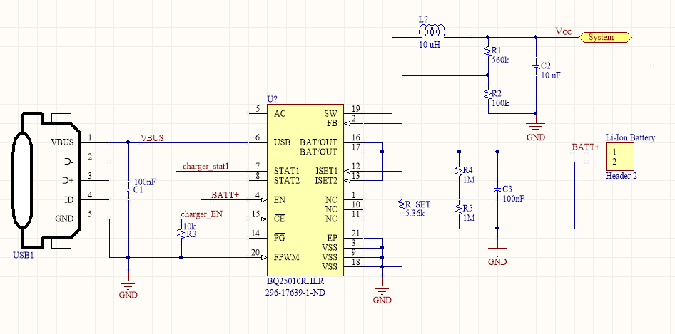

I am using BQ25010RHLR to charge the battery and provide 3,3V supply voltage for my Bluetooth unit.
when  I connect the USB to charge the battery it does not  charge the battery, it does not provide the 3.3V and the feedback reference voltage is 0V.
I checked that the 5V of the USB bus reaches the IC.
Now when I connect the VCC to 3V (look at the attached screenshot) it gets hot (80 C). and again the battery would not charge.
I did enable the charger by pulling down CE pin (by micro-controller cc2541).
This happend in all of my samples.

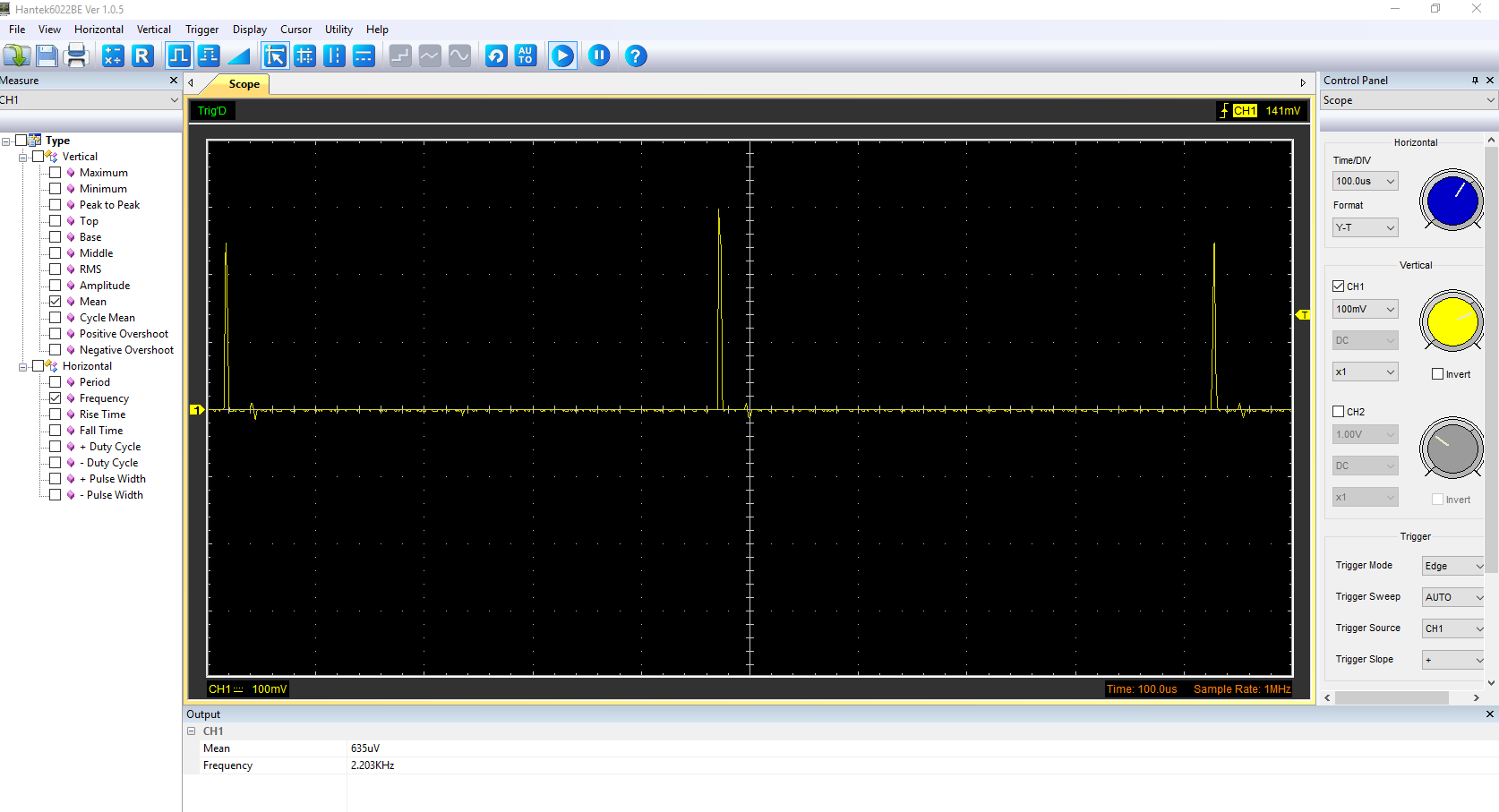

    -SW with USB connected is exactly zero with 10 mV spikes (very small)

    One basic question that I have to ask.  C3 on the schematic you sent is polarized and is connected backwards.  I expect that is not the case.

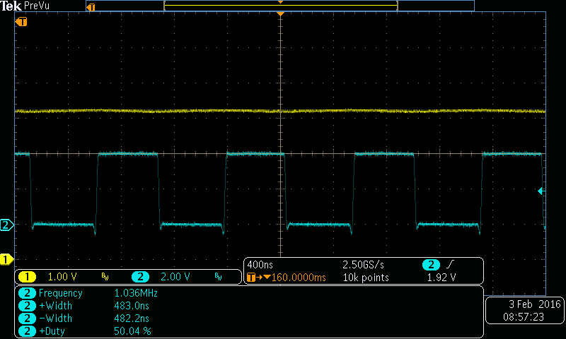

    I've done a bit more testing on the bq25010 EVM.  This is with the battery set to 4.2V and the EN pulled low.  The switching frequency is as expected.  (Channel 1 is BAT and Channel 2 is SW.  Since you are not even able to test with the battery, I'm not sure how much this will actually help.
    Do you have one of the bq25010 EVMs?  I would suggest testing one of the EVMs to verify its functionality.  Then, take the failing IC from your board and placing it on the EVM - this will prove / disprove if it is a part problem.  Based on you note that all parts have failed, I doubt it really is an IC issue.

    C3 is a ceramic cap and the mistake is only in the schematic graphic level. I really appreciate the tests and the time that you went through.

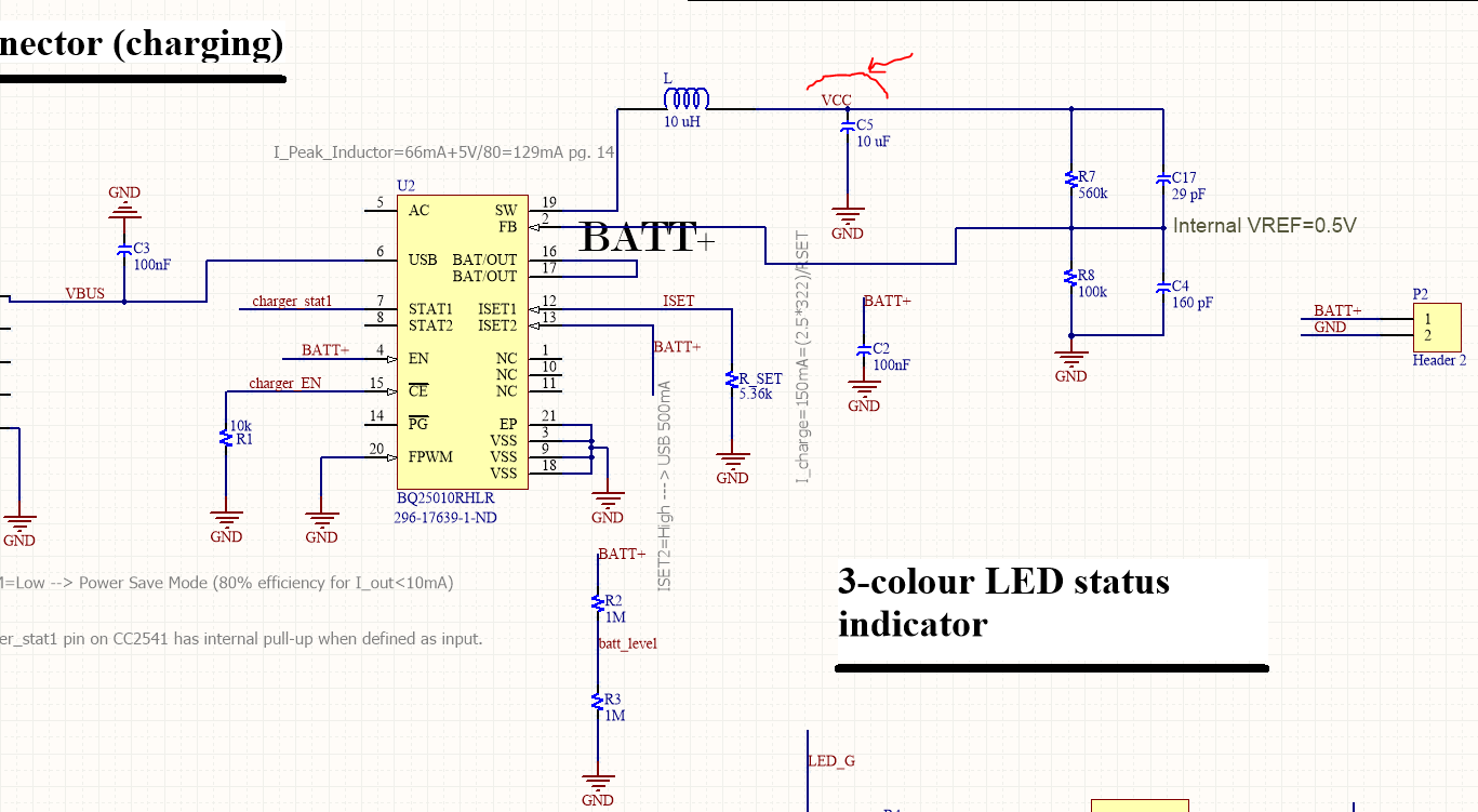

    First, I have simplified the schematic to show the changes we have made:

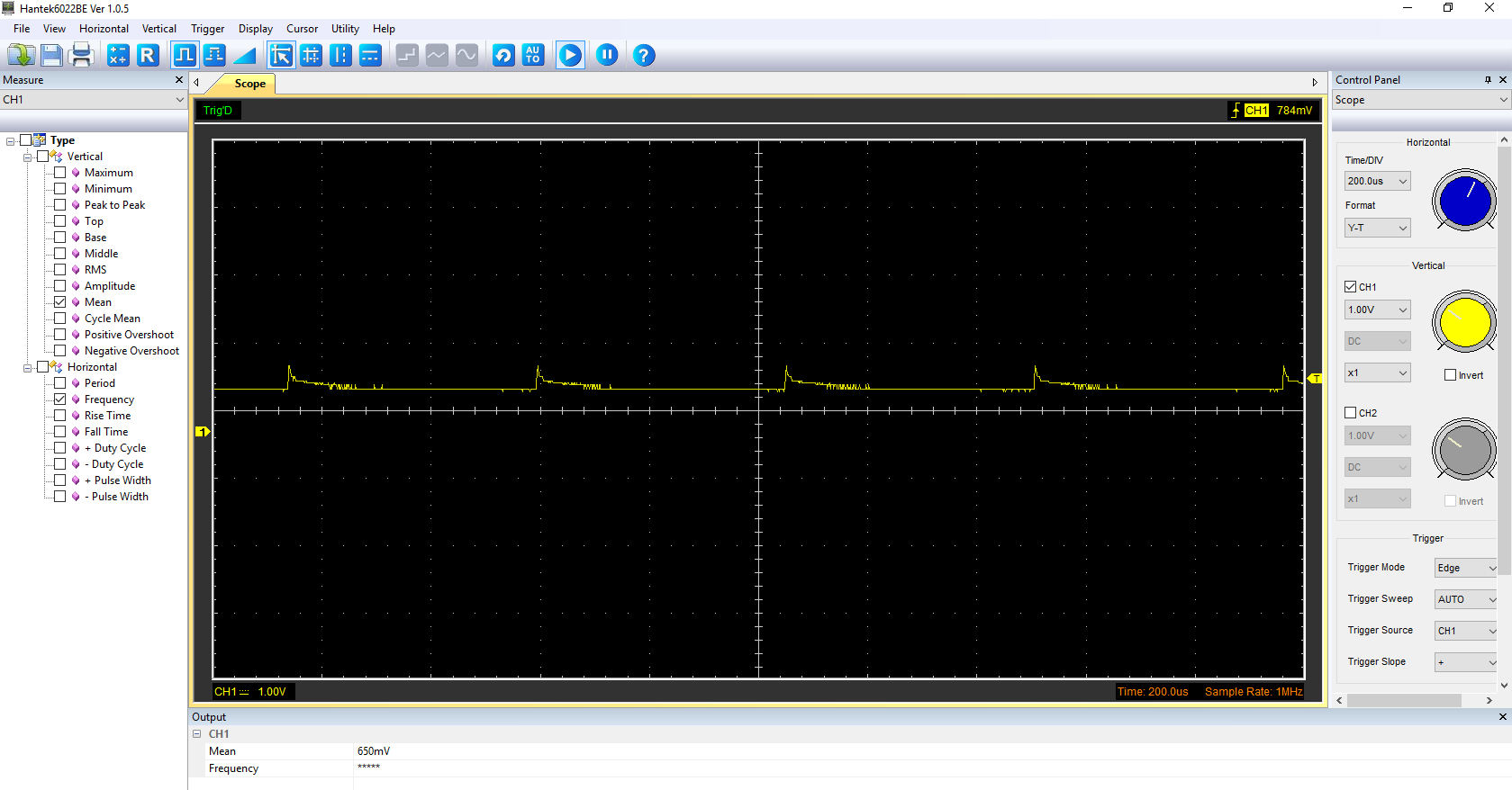

    The issue we are having at the moment is that the PWM signal seen at the SW output has a 12% duty cycle, giving us only 0.7V at Vcc for our system and approx. 0.1V at the FB pin (which should be 0.5V). This happens with the battery connected and with or without the USB plugged in. We have verified that the USB does charge the battery just fine.
    My questions are:
    1. In your last post you mentioned that you pulled EN low to get the wave forms you show, but when I pull EN low I get nothing out of the SW output. This also means that I have removed the battery, so ISET2 is left floating. Also, from the documentation, pulling EN low puts the DC-DC converter into shutdown mode. Should EN be high or low for battery operation? And is using the battery voltage wise or unwise for setting EN in your opinion?
    2. R4 and R5 are used to measure the battery level (sent back to the microcontroller from the midpoint), would having them connected as they are have any adverse effect?
    3. The Vcc is used in multiple locations on the rest of the board, and current draw can be over 150mA (depending on the code running on the microcontroller). If the system is trying to draw more current than the chip allows, would that result in the reduced duty cycle of the SW pin?
