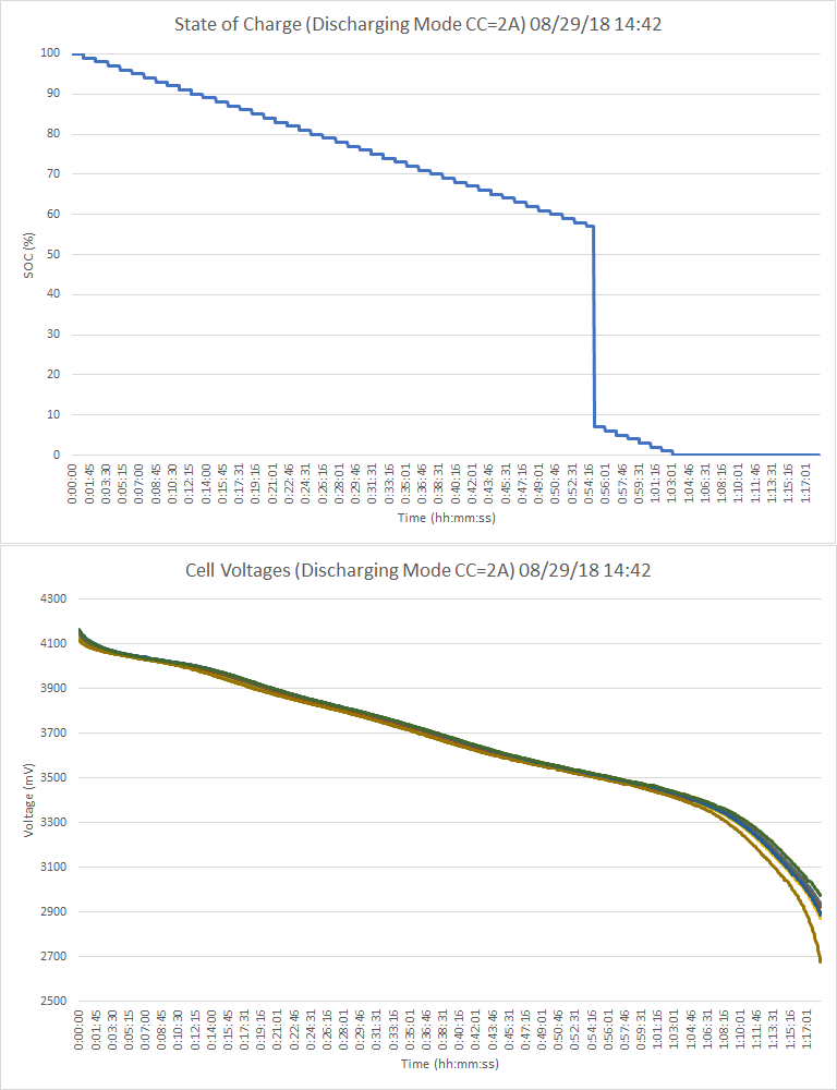

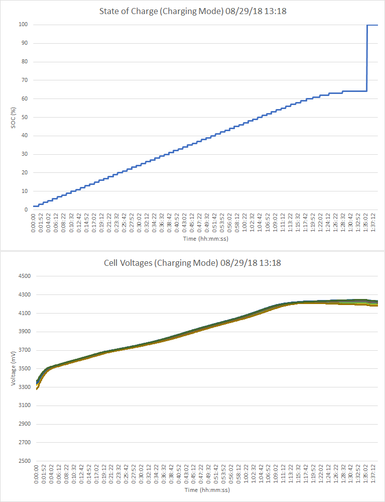

BQ78350: SOC jump from 64% to 100% in charging mode and jump from 57% to 7% in discharge mode.
Part Number: BQ78350
Other Parts Discussed in Thread: BQ76940EVM, BQSTUDIO, BQ76940, GPCCEDV,

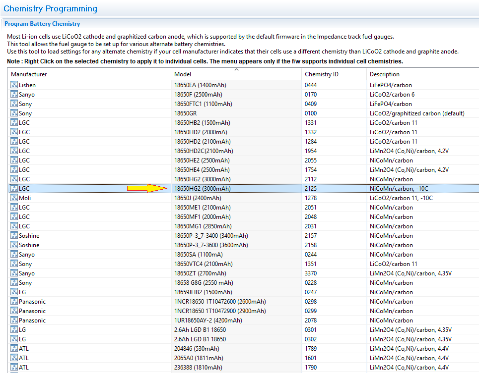

I am using the BQ76940EVM eval board and a 12S1P 18650HG2 (Chem ID 2125) battery cells.
SOC jump from 64% to 100% in charging mode and jump from 57% to 7% in discharge mode (See graphics below).
Also please find the log files here:
2A_Discharge_082918_1442.log
Charging_082918_1638.log
Any help will be appreciated.
  • Hi Jorge,
    I will review your log files and get back to you tomorrow. Can you also send me your .gg file?
    The jump to 7% during discharge indicates at least one cell is hitting the EDV2 voltage. If you are setting the CSYNC bit, the jump to 100% during charge might mean that the charge termination voltage has been reached.
    I will review your log files along with your gg file to see what might be going on.
    Matt

    For the discharge cycle, the jump to 7% happens because one of the cells is crossing down below the EDV2 voltage threshold. For the charge log, when 4.2V is reached, the current starts decreasing. When it falls below the taper current for a specified amount of time, the battery is considered fully charged because the charge termination conditions are met. The CSYNC bit is set in your gg file - this tells the SOC to sync to 100% when full charge is completed.
    I think the full charge detection is working correctly. The issue is that the gauging is not accurate with your current settings. Did you run all of the calibrations and select the correct ChemID for your battery using bqStudio? This is very important to accurately set the voltage curve for your battery.

    About the Battery Chemistry, I am selected ID2125. Battery Data sheet is attached. Could you pleas confirm this is the right ChemID?

    I think you have selected the correct ChemID.
